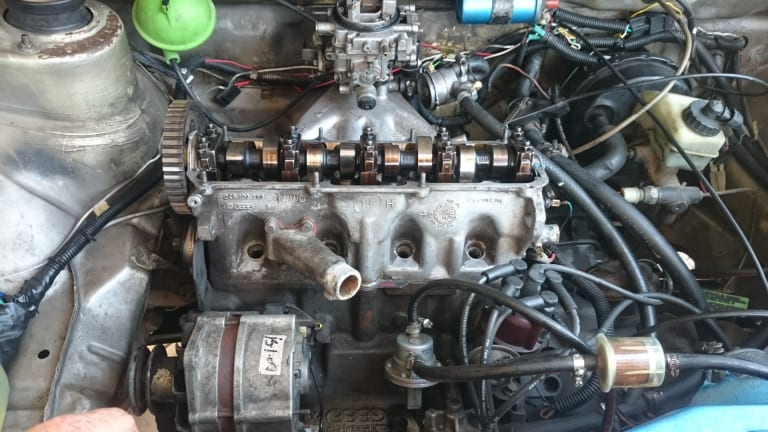

just bouht a new engine 1588 for my cabbi
the water flange is on the left side [today i own a motor with left side flange]
does it have any meaning?
The 2nd picture is a 1.6 head, top hose between cylinders 1 and 2
So the newer engine you bought in the 2nd picture has the right head for a 1588cc block. Is the picture and engine in a Mk1 Scirocco?

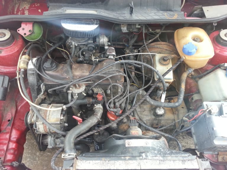

1588cc FR engine as fitted to my Mk1 Scirocco

Could of had a head swap in it's life as the top hose looks like it's the wrong one for a 1.8 and has just been bent over to fit?
My 1.8 DX engine, not the best picture but you can see how the top hose runs.
