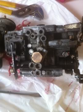

For whatever reason its stopped idling. Last week it would happily sit at 700rpm but now the minute you push the choke in and it drops below 1300 it just dies. I've spent hours checking fuel filters, looking for vacuum leaks and I just cant figure it out.
Its a weber 32/34 and i had it stripped down and cleaned out by a mechanic back in may. He said it was as clean as a whistle therefore I don't think its that. Anyone got any Ideas or in the Teesside/Darlington area that wouldn't mind taking a look?
cheers Richard
One thing i did notice was there was a brass screw that was sat on top of my exhaust manifold that i very clearly remember been connected to the front of the carb. I've since refitted and tightened it up. The screw can be seen in the image below, brass one. Does anyone have any ideas what its for? please bare in mind the image is sideways.
Seems your running issues were a combination of both air leak i.e split in the carb flange and the idle screw missing.
