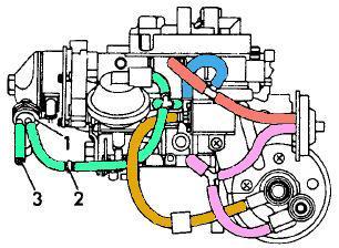

where does the number 3 in the diagram go?
I think this is your answer to the carb pipes.
1. Thermo-pneumatic valve
2. Restrictor
3. Straight connection hose
Stage ll vacuum control unit
1 This device is fitted to 1.6 litre manual gearbox models and 1.8 automatic gearbox models from August 1984 on. Its function is to delay the Stage ll opening slightly whilst the coolant temperature is below 18°C. It achieves this by venting the vacuum hose via the thermo-pneumatic valve and the resistor (see illustration).
2 Check that the straight hose at connection 3 on the thermo-pneumatic valve is not blocked and check the valve itself by blowing through it. It should be open at 18°C and close when the temperature rises above 28°C.
