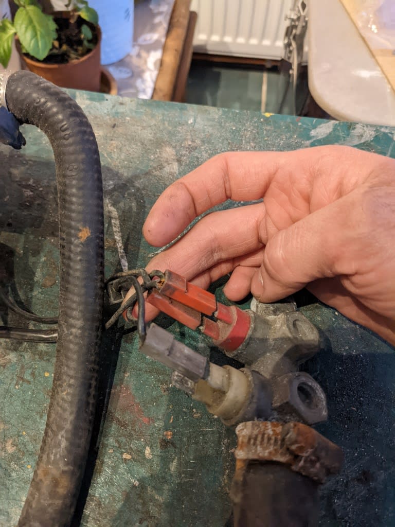

 My cars got the old "hedgehog" intake manifold preheater in my engine bay. It's only got a single red wire running from it - this is too short to connect to one of the thermoswitches the engine bay, and instead runs to a matching red wire in the engine bay.
I've no idea what goes on the fourth terminal of the second thermal switch, but I guess it relates to the carb intake manifold preheater? Anyone know?  :cool:picture of how it looks off the car:
The white terminal is a live feed and splits to the idle cut off valve and the second thermo switch (the red terminal) , supplying live power to them.
the second red terminal is for the auto choke.
No idea what goes opposite the white connector on the thermoswitch.
