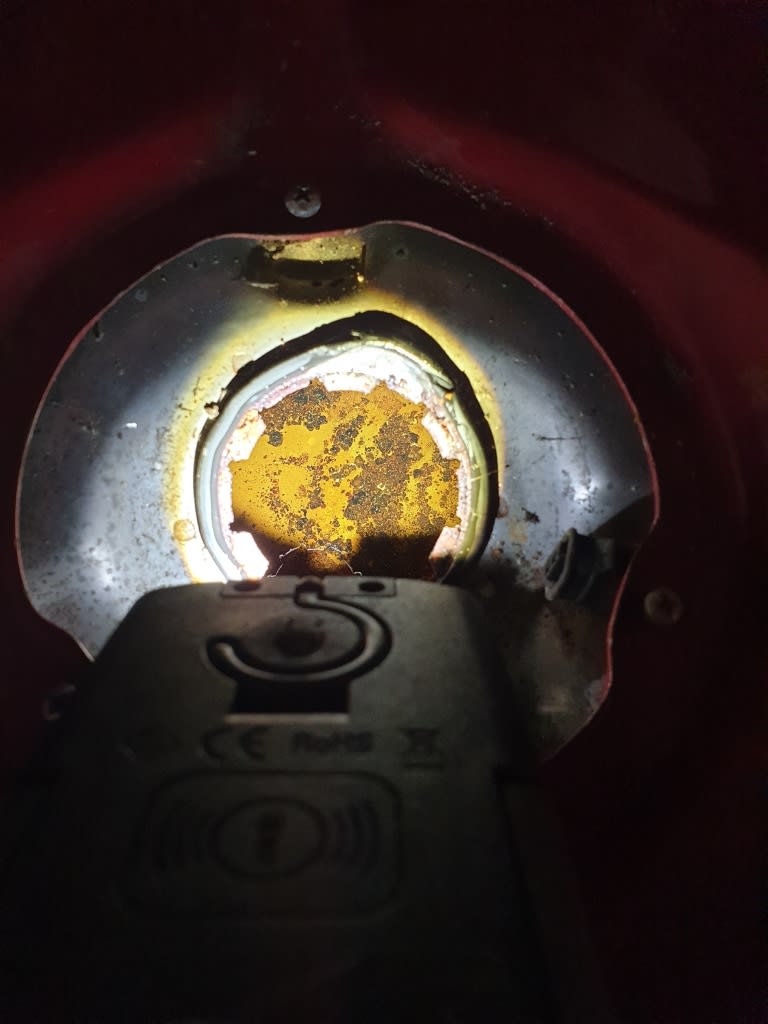

So I took your advice and was careful taking the plastic sender out, the O ring wasn't seated correctly in the first place.
Took it out, cleaned it up and set it aside. Looked in the fuel tank and it looks like a beach in there :(So I'm going to take the tank off and wash it out completely.

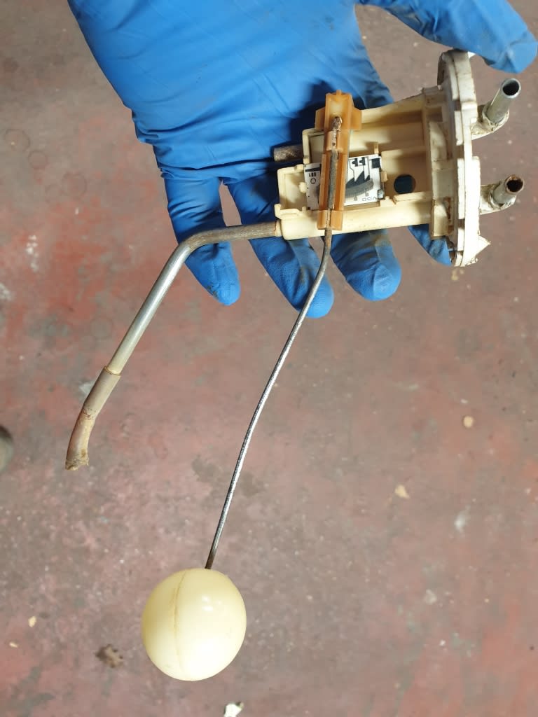

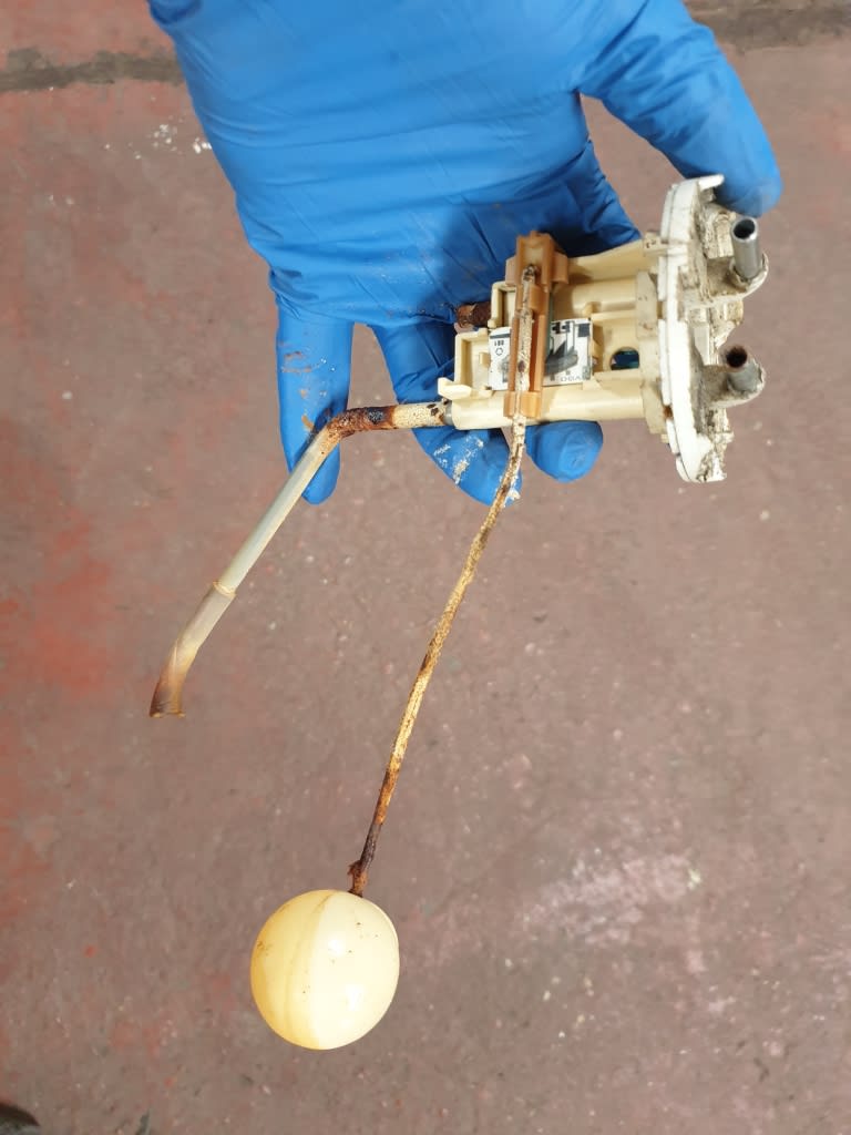

Pictures from this 20210414_160525.jpg 20210414_160624.jpg 20210414_162319.jpg
1989 Paprika Red 1.8 Clipper Cabriolet
the bottom end of the pipe has a plastic sleeve on it, looks like something was fitted to the end of it?
Should there be some sort of large strainer on there or filter?
If you google Mk1 golf fuel sender there does seem to be something on the end of the pick up pipe.
The one in my Mk1 Scirocco does not have anything on the end but it's the metal type fuel sender and mine works fine with nothing on the end so I would not worry to much just change the fuel filter on a regular basis, I change mine every couple of years or 5,000 miles as I don't do a lot of miles.

You could try and go fishing in the tank with a magnet on a stick/wire and see if any of the bits stick to the magnet then once it's cleaner, clean the magnet and leave it in the tank to collect any other bits, I've got a magnet in my tank… But if it's sand/dirt it won't stick so it will need sucking out via the hole above the tank or the tank dropped and cleaned out.
Check the fuel filler neck for any holes near the filler cap, remove the filler cap and shine a torch down it.
 If it's solid lift the back of the car and give it a very good clean under the wheel arch near the top of filler neck. I clean mine out twice a year, before and after the winter.

Yeah it just looks strange on the end of the pipe and everywhere I was looking doesn't even show the pipes it just shows the float 🙄

This pic show something on the end but not sure what it is… perhaps someone with the same sender as you will confirm what's on the end.
https://vwgolfmk1.org.uk/forum/index.php?page=topicview&id=classifieds%2Fparts-wanted_2%2Fconvertible-fuel-sender
Yeah I see, probably just a particle filter before hitting the actual filter?!
Unless there is somewhere to get one I'll just go with cleaning the tank out and filer neck then replace the filter as and when
