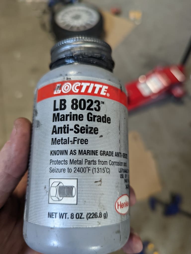

Yeah sure I used copper grease on the studs prior to fitting the new one, always apply on new stainless steel items to prevent them making a bond.
Also BTW I can only recommend the use of a gearbox lifter when dissembling the manifold from the downpipe-thing thats sitting on the manifold with 2 solid C-clamps, its easier to get those of if you’re able to lift the downpipe slightly to release tension from the clamps..

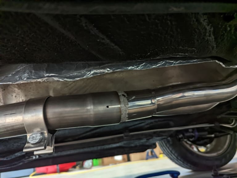

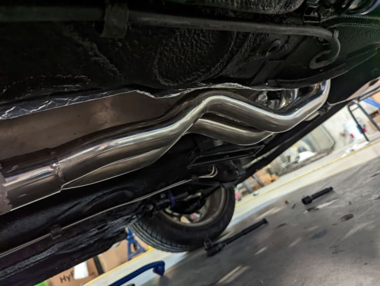

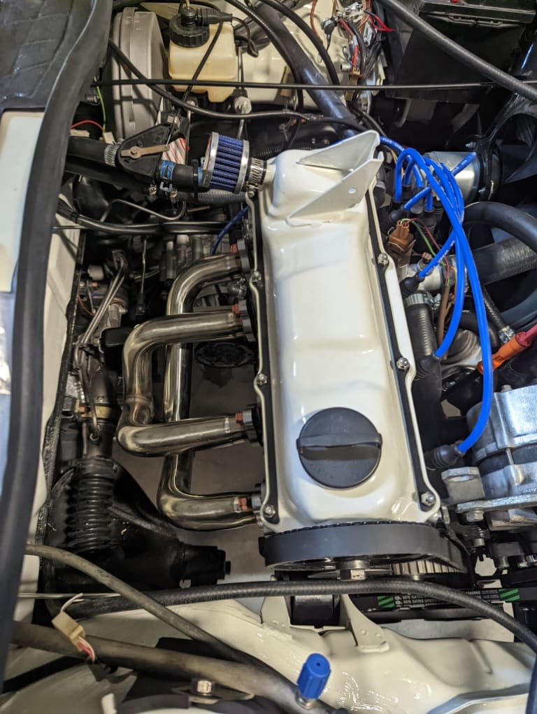

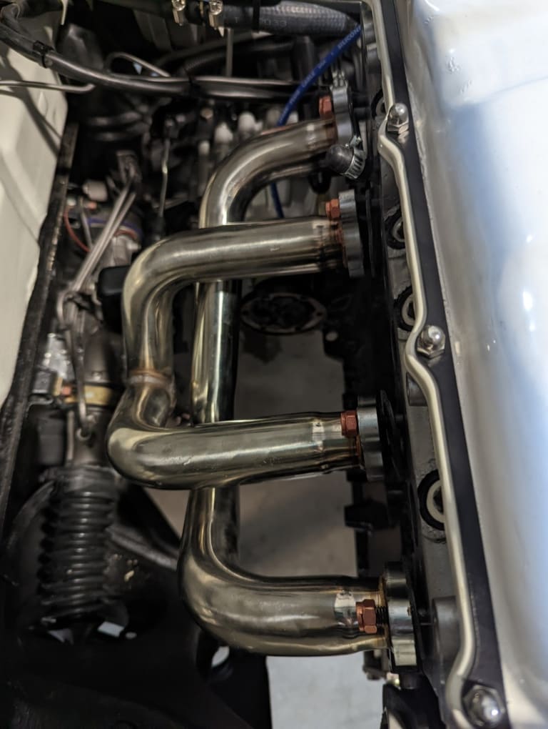

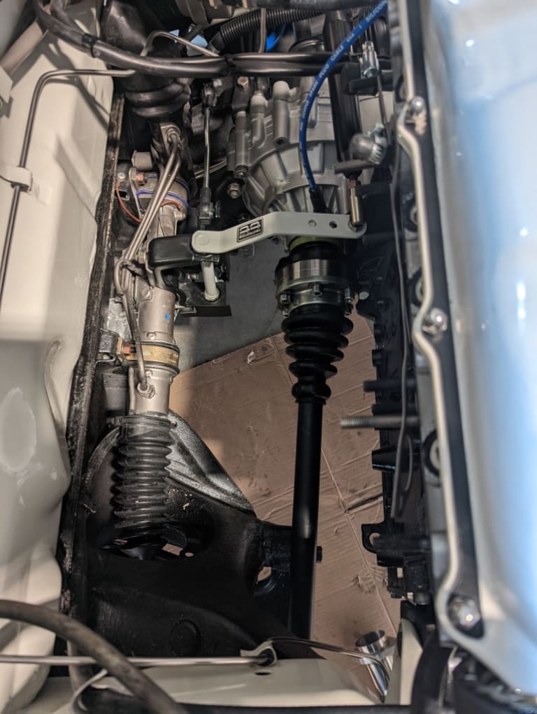

Few pics attached. Any help or ideas appreciated.
![PXL_20220710_205421812.jpg PXL_20220710_205421812.jpg](https://res.cloudinary.com/mk1-golf-owners-club/image/upload/c_limit,w_768,f_auto,q_auto/v1657486507/uploads/attachments/62cb3ca9f1dcd.jpg)
![PXL_20220710_205333160.jpg PXL_20220710_205333160.jpg](https://res.cloudinary.com/mk1-golf-owners-club/image/upload/c_limit,w_768,f_auto,q_auto/v1657486512/uploads/attachments/62cb3cafc3c93.jpg)
![PXL_20220710_205346207.jpg PXL_20220710_205346207.jpg](https://res.cloudinary.com/mk1-golf-owners-club/image/upload/c_limit,w_768,f_auto,q_auto/v1657486515/uploads/attachments/62cb3cb298b01.jpg)
![mark1gls in the usergroup ‘Local hero’ mark1gls in the usergroup ‘Local hero’](https://vwgolfmk1.org.uk/themes/default/images_custom/2T6Iw1M8.png)
Possibly the drive shaft but not sure as when I fitted mine I had the engine out so the manifold went in before the engine and gearbox.

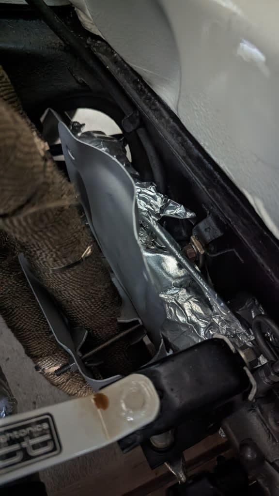

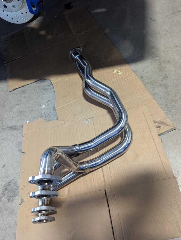

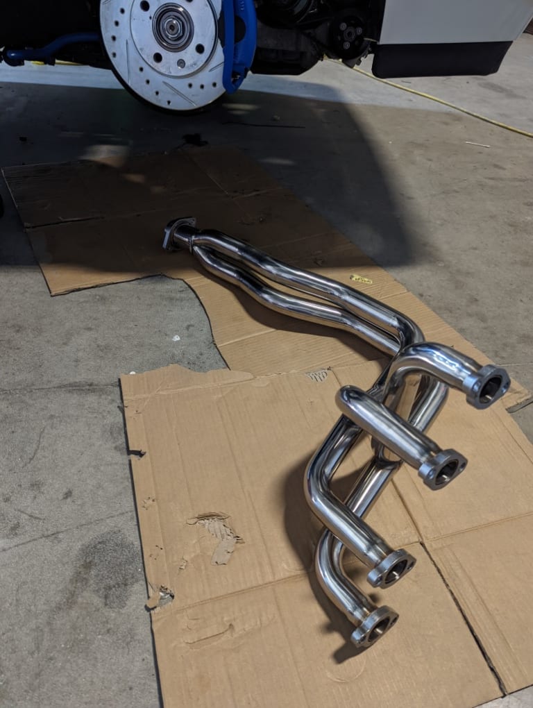

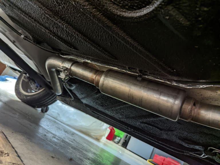

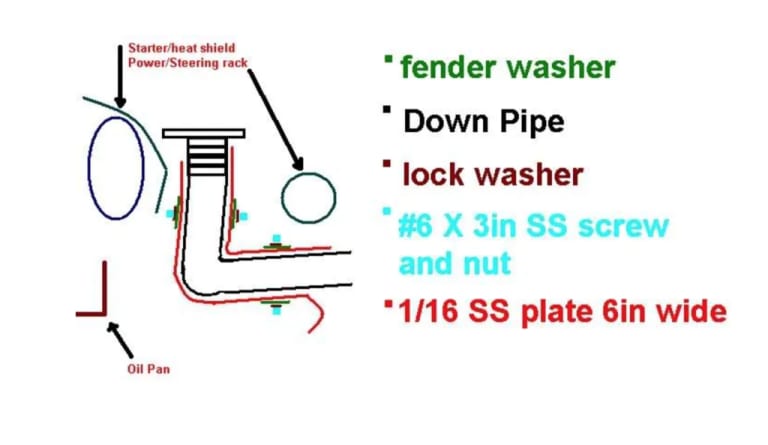

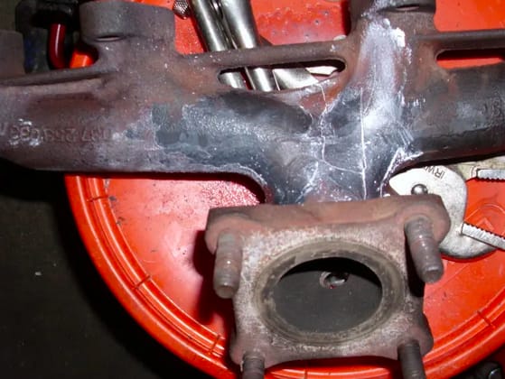

Did the same thing on my dial down pipe on my next Cabriolet, I used left over sheet aluminum. Some folks over here use that exhaust heat shield tape, but being the Cost effective person that I am, I used what I had laying about, and if my header cracked I wanted to see it.
an OBTW on all 3 of my Cabbies with the OEM exhaust manifold they all cracked, I suspect that it was from poor design, and broken mounts.
![Screen Shot 2022-07-11 at 10.25.58 AM.png Screen Shot 2022-07-11 at 10.25.58 AM.png](https://res.cloudinary.com/mk1-golf-owners-club/image/upload/c_limit,w_768,f_auto,q_auto/v1657549925/uploads/attachments/62cc3463d9013.png)
My old Toilet Bowl on my diesel never cracked in the 20 years of ownership.

Also wrapped my steering rack boot with a plumbs soldering mat as it's right next to it on left hand drive cars.
Picture on page 1 in the link to my build thread.
