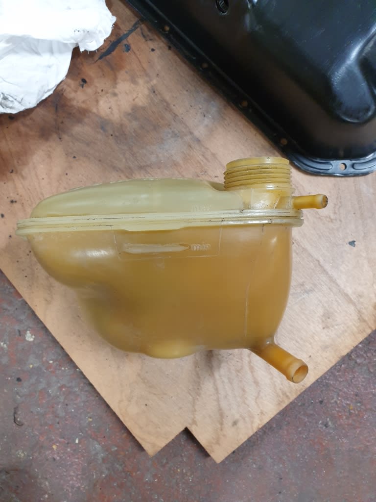

Any idea how to save this header tank? Something to make it easier to see the level once put back on? Bleach?

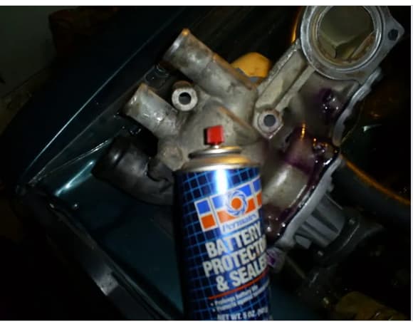

If you are replacing your WP, then I urge you to buy a 1/4 drive inch/lbs torque wrench and one at a time remove all the bolts on your WP (if you buy the WP and housing together.) and apply copper grease to the bolts as they will corrode and be harder than hades to get out later.
Going back set the re-greased bolts to 87 in/lbs or NM setting spec'ed in the Bentley. You won't strip them, and they will be secure.
Added Protection for the bolts is to Spray them with Battery Protective coating on the back side, as it prevents corrosion from creeping up the back side of the bolts.

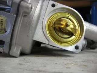

Drilling a hole in the lip of the t-stat, 1/8 or 1/16 of and inch prevents the air bubble from hades if you don't fill it properly.

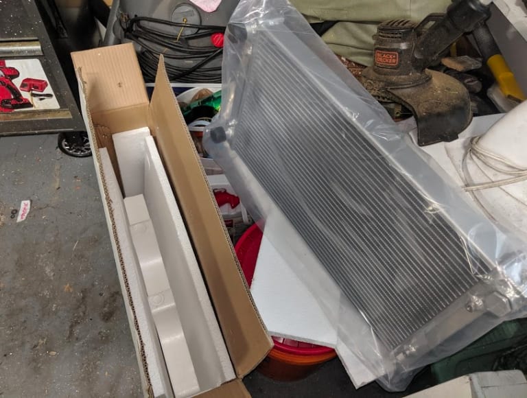

and the newer all aluminum Radiators operate a tad bit cooler, and well the only thing I had to do was to remove the bosses off the Front that can hold a radiator fan,
