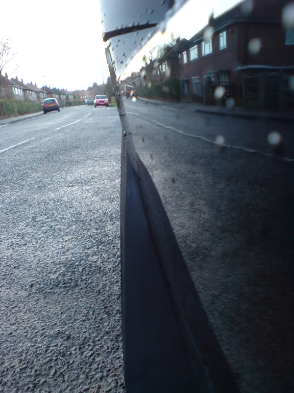

Here's some pics of the rear wheels…
N/S
O/S
O/S
N/S
N/S
O/S
Back Shot
DEFINATLEY looks like the camber needs to be adjusted on that one.....
