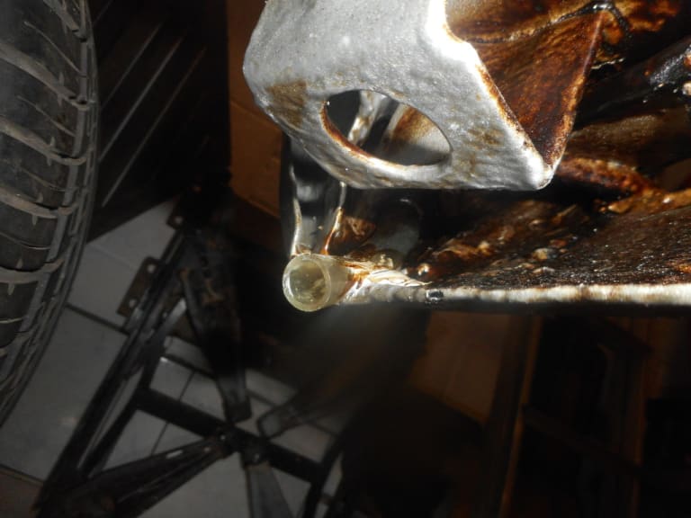

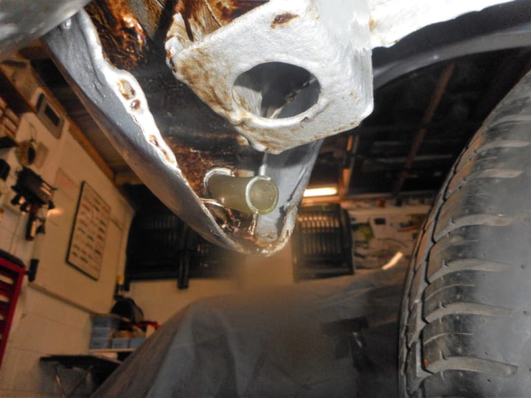

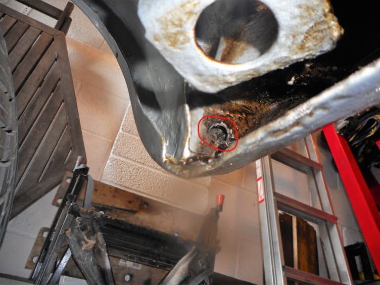

They finish in the void behind the rear wheel arch - just dangling there. Water therefore runs out of them and collects in the blind void - rotting it! This must have happened from new - very un VW like!! I think there may have been a very small drain hole - but asking a lot!!

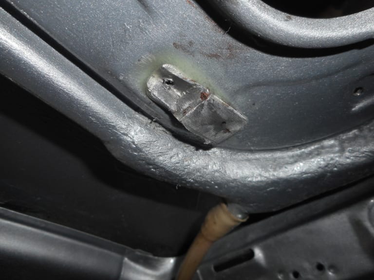

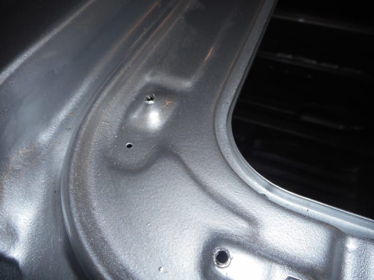

I wasn't happy with this so decided to drill a new drain hole from under the car into the void. Very tricky job!!

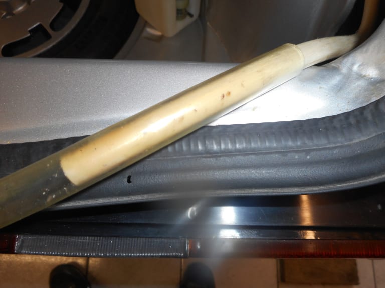

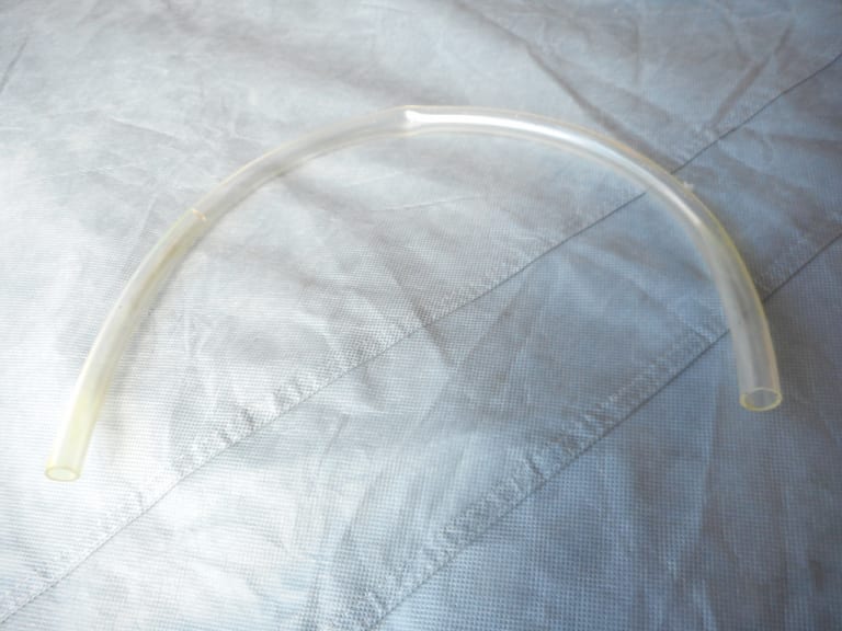

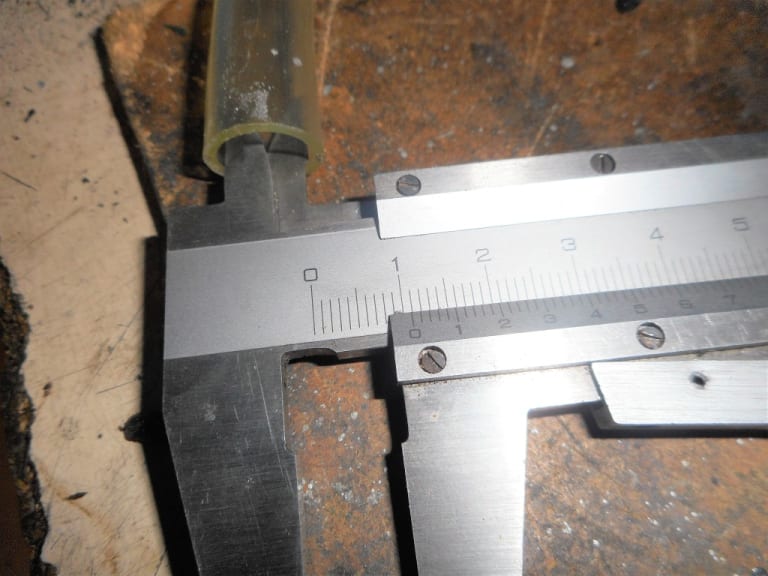

I then found some clear fairly rigid plastic tubing that pushed tightly over the end of the existing drain tubes.

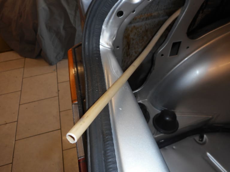

I could then feed this out through my new drain hole
I then used some PU seam sealer to hold the pipe ends in position.
I found that by feeding a length of old curtain spring down first and out through the hole - I could push the drain tube over the curtain spring and slide it down much more easily.

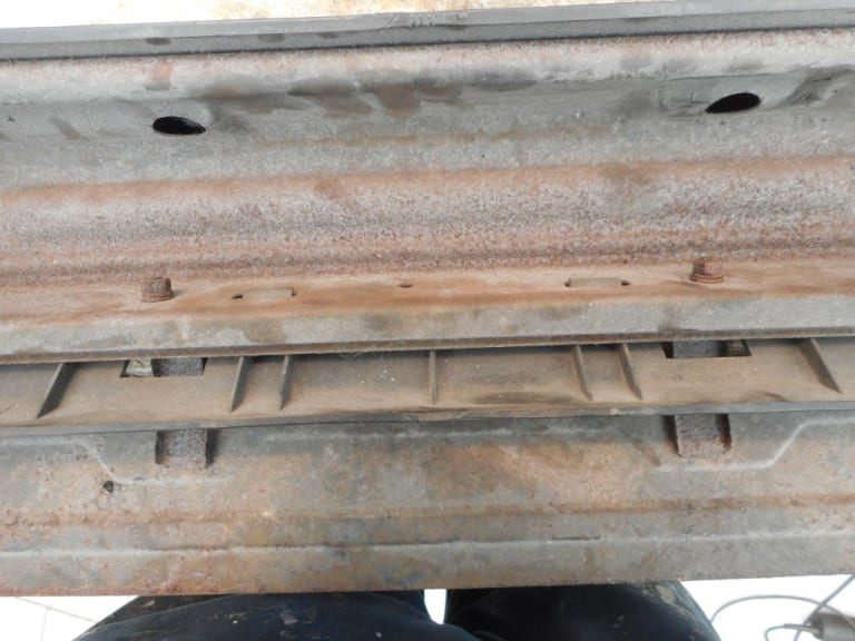

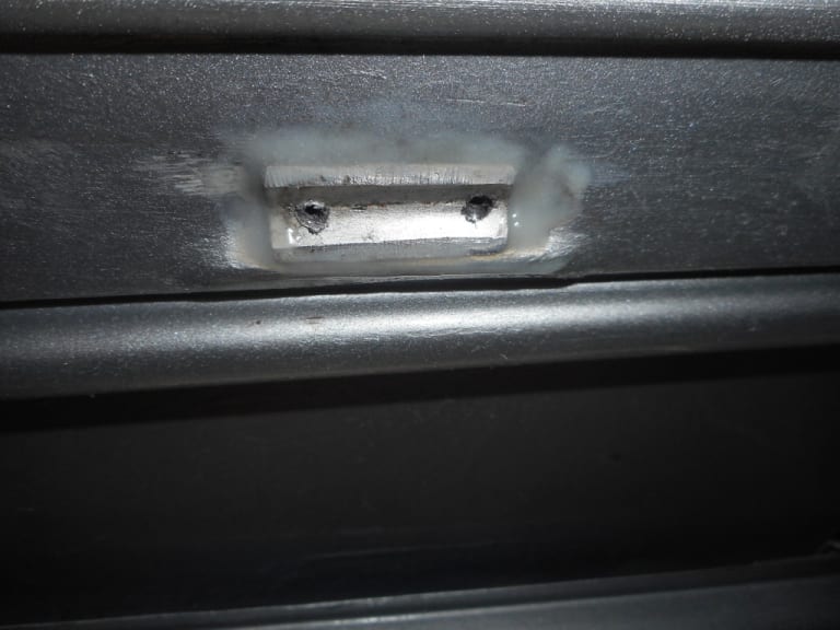

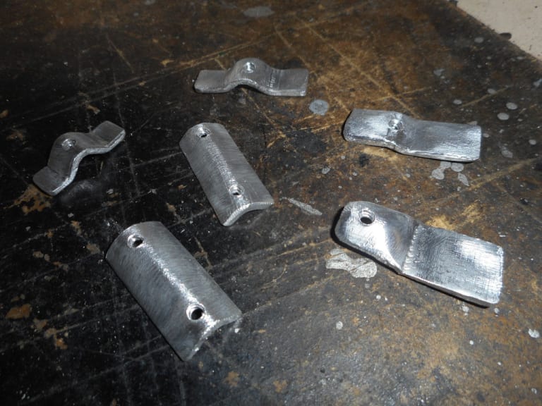

I wasn't happy with screws fixing into just a thin sheet of steel anyway so using some thick alloy I made some sections to fit under the existing holes. Very time consuming due to the curves of the underside of the sunroof surround and the recesses where I had to fit the new pieces.
Once drilled I used araldite to fix them in position.

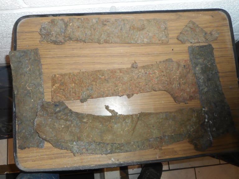

The old

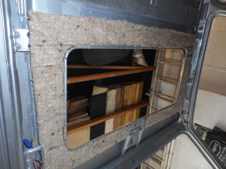

Bought some new felt online.
All fixed in place

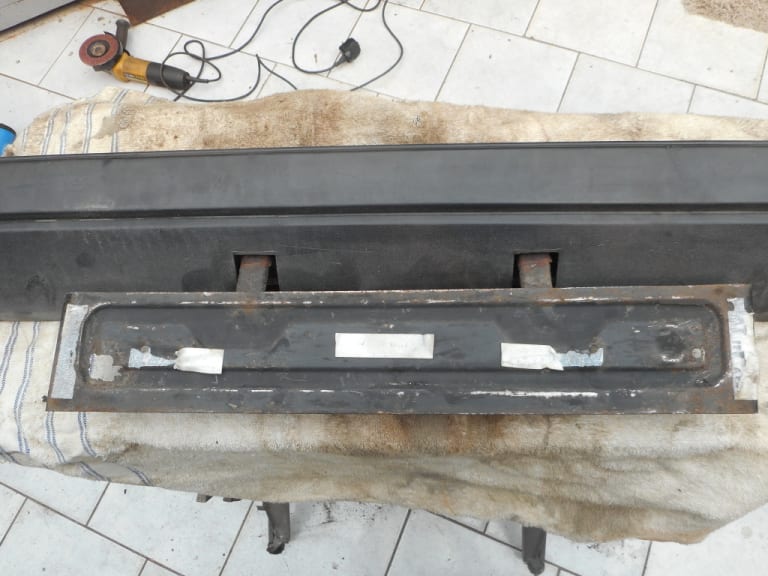

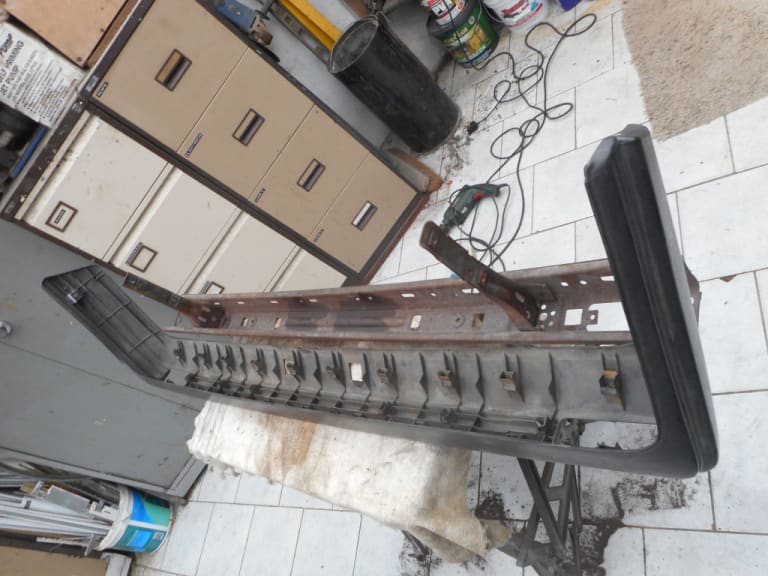

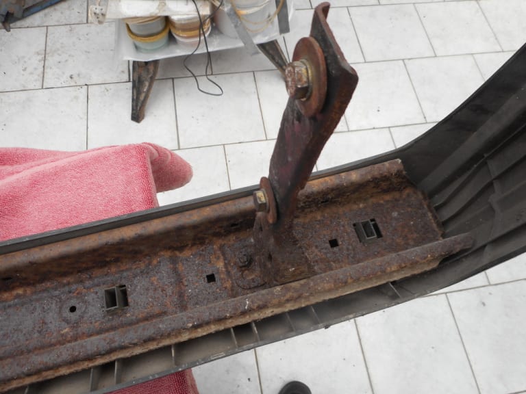

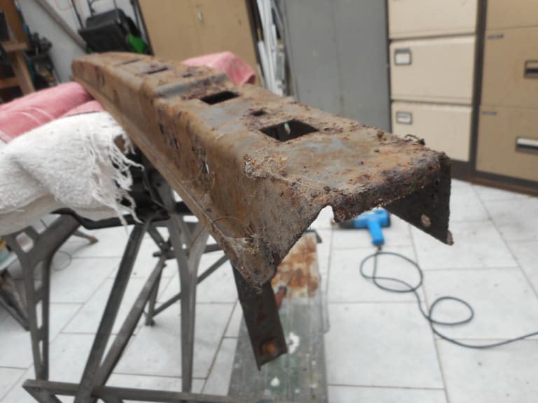

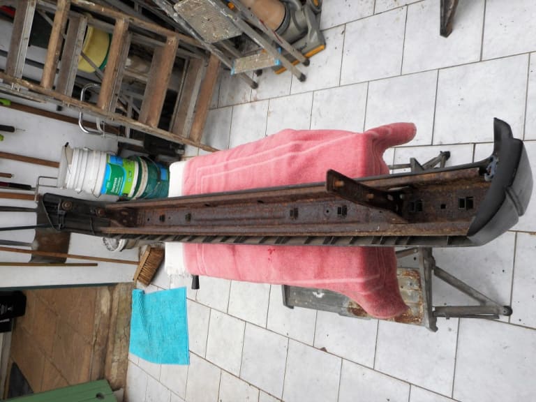

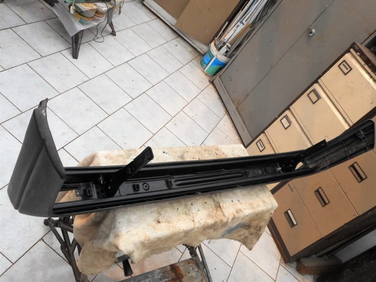

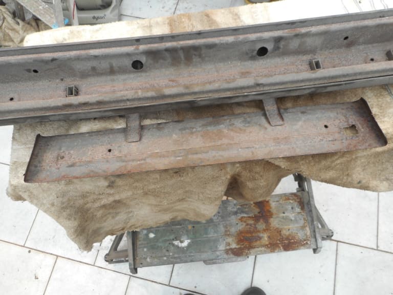

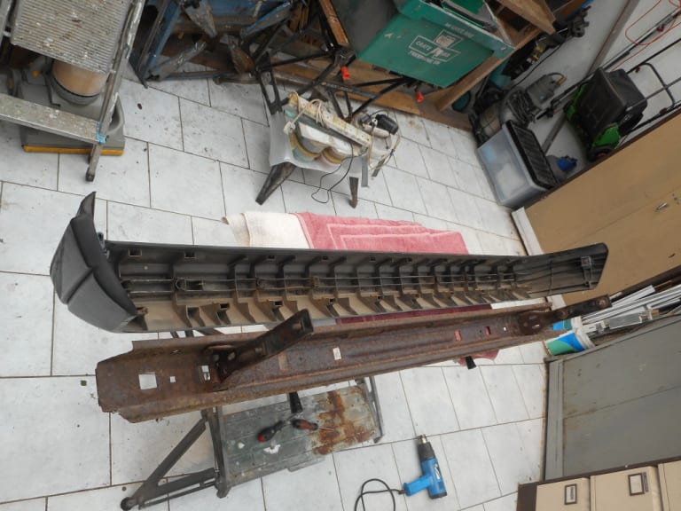

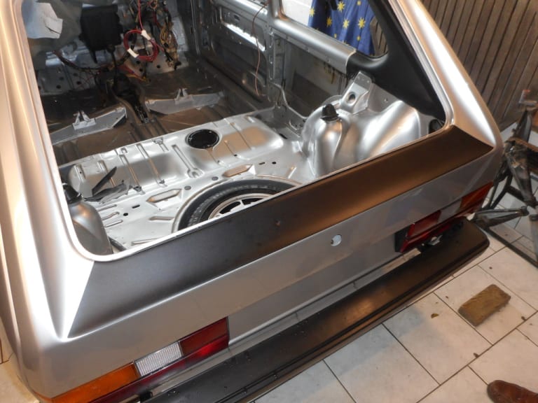

First the rear bumper
I had no idea if this was possible - and I didn't want to damage plastic covers….. Some people had suggested there was adhesive/seam sealer used so I did warm the plastic with a hot air gun first.

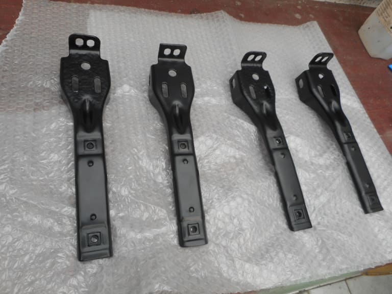

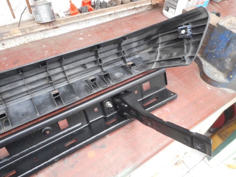

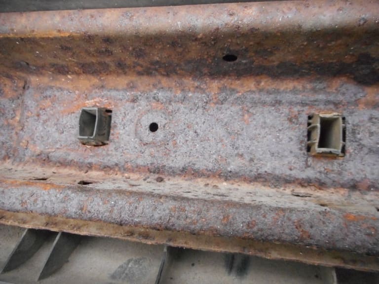

I could see on the wrong side of the bumper that there were plastic "blocks" that had snapped thought the metal beam. I carefully used grips to "squeeze" them so they could pass back through the metal beam.

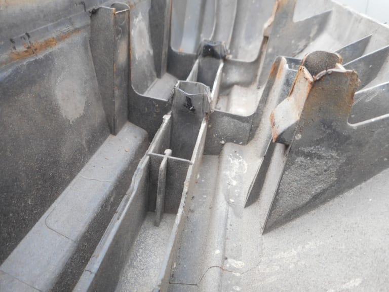

Then carefully using screwdrivers and plenty of squeezing, pushing and shoving they finally separated.

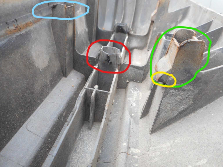

It was only then that I could see how they were fixed together. No sealants/glues used at all! Al dry snapped together.
On the image below you can see the fixings. The part ringed in blue was merely a guide - with no latches. The part ring in red had to be squeezed to get the latching sections through the beam. The part in green had latches ringed yellow.
Again same process used - warmed it using a hot air gun; squeezed the middle plastic blocks and "carefully" persuaded the rest to separate. Not easy !!!

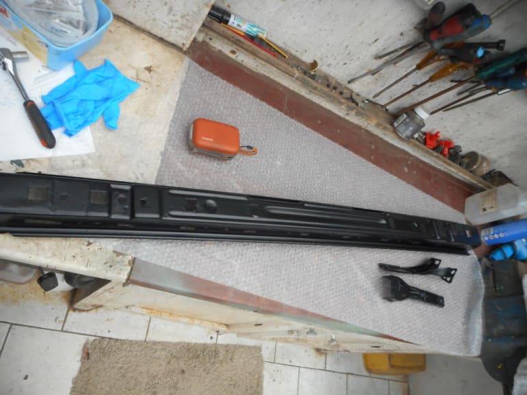

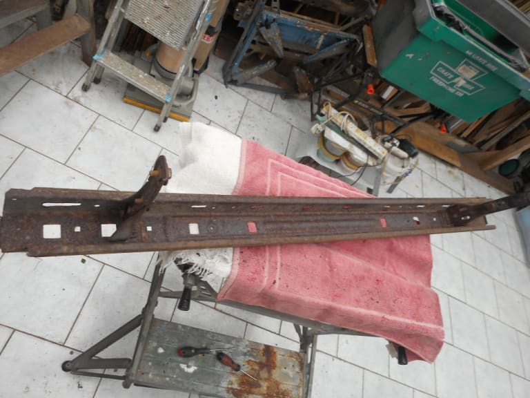

I then had the beams and brackets galvanised and powedercoated.
Refitted the brackets with stainless fittings.
Then a reversal of the separation procedure.
Having reformed the "squeezed" blocks to shape I gently clamped the beam and the cover together - taking care not to damage the plastic - and by using plenty of pressure evenly along the bumper - lots of sweat, cursing and shoving - it all clicked back together!

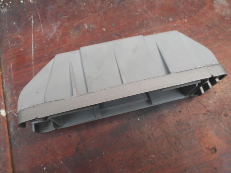

I'm assuming that you have the original number plate plinth thingy, if you do, would you mind snapping a few pictures as I need to make one up. Be good to see what an original one looks like as I must have binned mine!
paceman said
Good work there mate. Always thought they looked easy to remove but clearly looks aren't everything!
If you need any more pics/measurements get back to me.

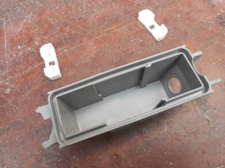

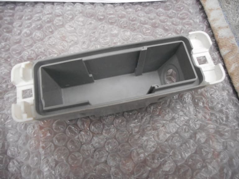

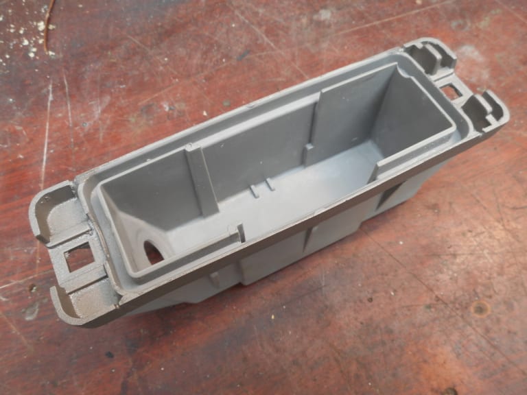

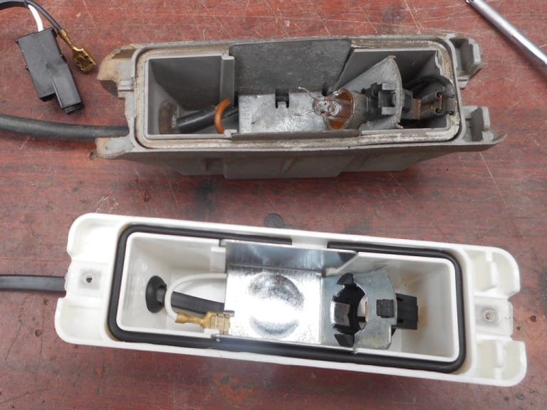

Will take some pics for you. Mine wasn't in great shape - big hole in it and also pretty rotten supports. Rather than lots of fiddly metal bending/welding I bought a replacement stainless version from CrazyQuiffs.
However when I received the replacements I realised I could swap the internals from the new to the old - and try and repair the one broken unit so keeping the originals - which were fat better quality than the replacements.
Old and new. Note the broken fixing points on the old
I sawed off the fixing points from the new fitting and cut off the remains of the old ones.

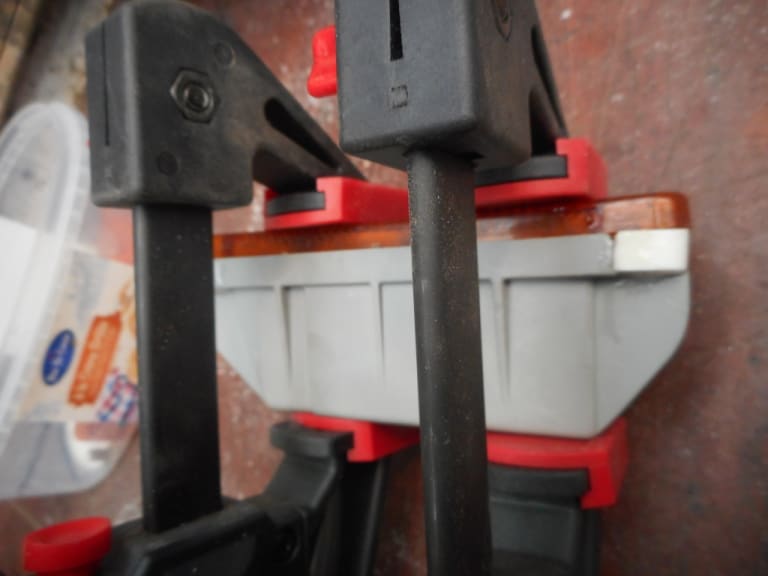

Glued the new parts to the old unit - clamping it in place using the old lens
Pretty good result after a bit of filing and cleaning up
Quick waft of silver paint - and although not prefect I'm pretty pleased with the result

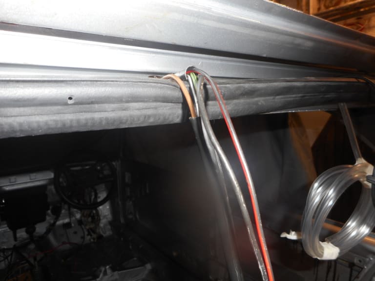

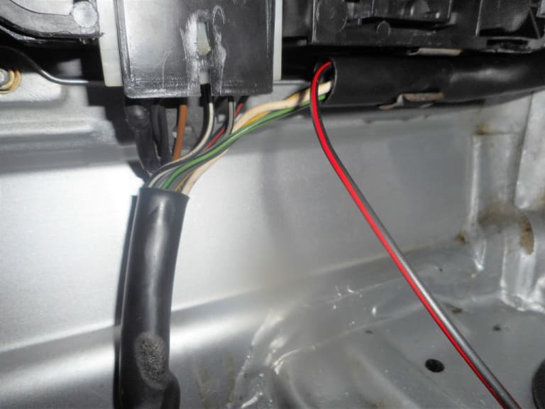

I ran a new red/black wire as per original brake wiring from the rear light cluster, where I will join it to the brake light, through the sleeving and out through the little grommet with the heated rear window wire.
For the negative I ran a new earth wire from the earth point above the headlining above the tailgate again through the heated rear window grommet.

Was tricky feeding the wire through the sleeving but not impossible - worst part was the sleeving below the passenger side rear light - once through that section it was easy.

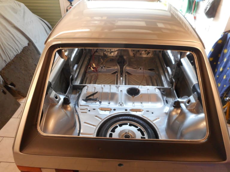

Two jobs I really wasn't looking forward to were up next…. headlining and rear tailgate GTI decal around the rear window.

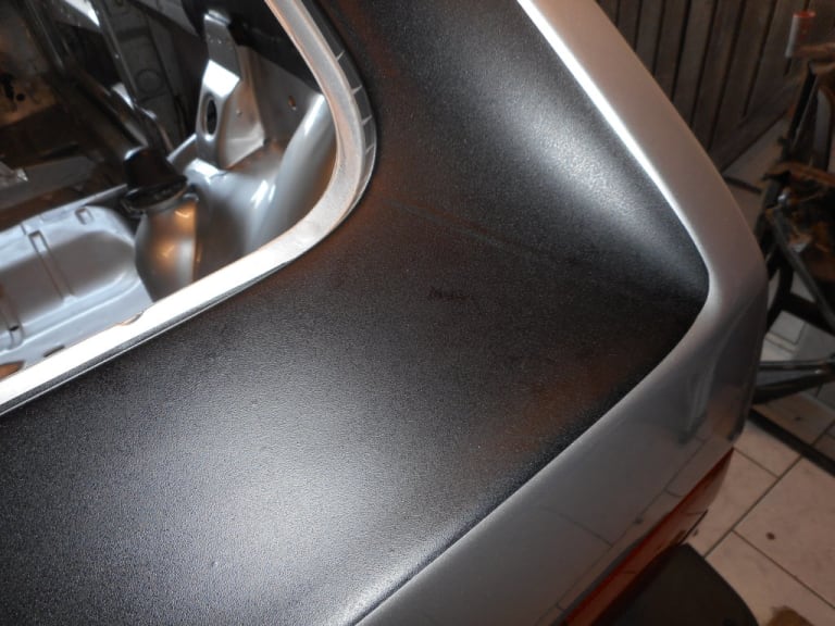

Having purchased an online kit I thoroughly cleaned the metal surface with IPA. I had read up about fixing the decals and decided to try the "wet method". This involves mixing a very weak soapy water solution in a spray bottle to wet the metal and reverse of the decal. Lay the decal in place and then "squeegee" out the water from underneath with a credit card.
Having dry trial fitted the decals to make sure they aligned correctly I started with the bottom and largest section.
Removing the water from under it proved almost impossible……. I was chasing bubbles all over the place. Having persevered for some time I was not happy with the finish so gently lifted the decal up, dried under and reapplied - which good success.
I decided that from there on I would apply the remaining section "dry" With another person helping I lined up the ends and gently applied them to the body, then the other person used a credit card to smooth the rest of it onto the metalwork. This proved far easier and gave a good result.
Really pleased with the finish - and a nice texture like the original.

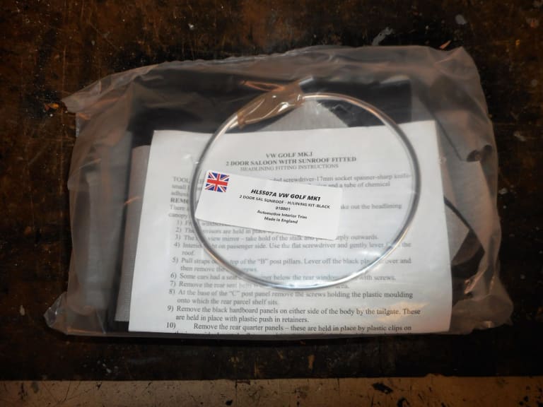

I bought the headlining kit from Newton Commercial
https://newtoncomm.co.uk/collections/vw-volkswagen-golf-mki/products/golf-mk-i-two-door-saloon-headlining-kit-sunroof-model
In fact I was on holiday in the area so popped into the factory to collect it. Sadly it was during covid which meant I was unable to go in for a look around the works.
The kit comprised the main headliner, A, B and C post pieces, a piece for the sunroof panel and their "Special" tool to help with installation.

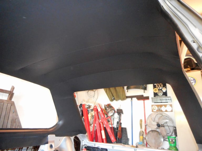

Then starting at the front (more of which later) I started fixing the fabric along the windscreen, then worked along the door opening tops, top of the b pillar and along to the c -pillars. Again it was tricky to avoid creases/wrinkles around the tight corners of the windscreen and b pillars. Making small cuts around the edge, which are hidden by the rubbers was essential.
It looked good - so I thought………..
I then came to fix the top of the C-pillar and above the rear window. This is when I realised I had a problem. I just had too much fabric. I just could not "loose" the excess without leaving great wrinkles/folds in the headliner. I was gutted to say the least. With my Dads help we tried and tried - no joy.
Sometimes I have learned you have admit when your talent/skills have reached their limits and professional help is required. I am not too proud to admit defeat and in this case had to admit it!
My problem was that the car is off the road - and I couldn't progress further - ie installing windows etc - until the headlining was sorted.
I contacted various car upholstery firms locally - but when I mentioned the word "headlining" they ran a mile. Eventually I came across Sew Good Upholstery in Newport, South Wales - not far at all from me
https://www.facebook.com/sewgood.upholstery/?ref=page_internal
Thankfully they understood my plight and were very kindly willing to come to my aid. They dont normally come out to customers cars but in this case they did.
Ian, the owner of the business, was clearly an expert in what he does. It took him a good four hours work but he miraculously rescued the headliner using great skill and judicious use of a hot air-gun. It was great to watcha pro and learn from him. He was impressed with what I'd achieved but I had made a few basic errors.
It was now that I learned to always start the job from the rear of the car. This is where you have the most fabric to deal with. He used a hot air gun - a lot - but always kept his thumb on the fabric where he was heating it - if his thumb was too hot - the fabric was at the limit of heat application. A careful balancing act was required and he was able to both shrink and stretch the fabric as required.
Finished article

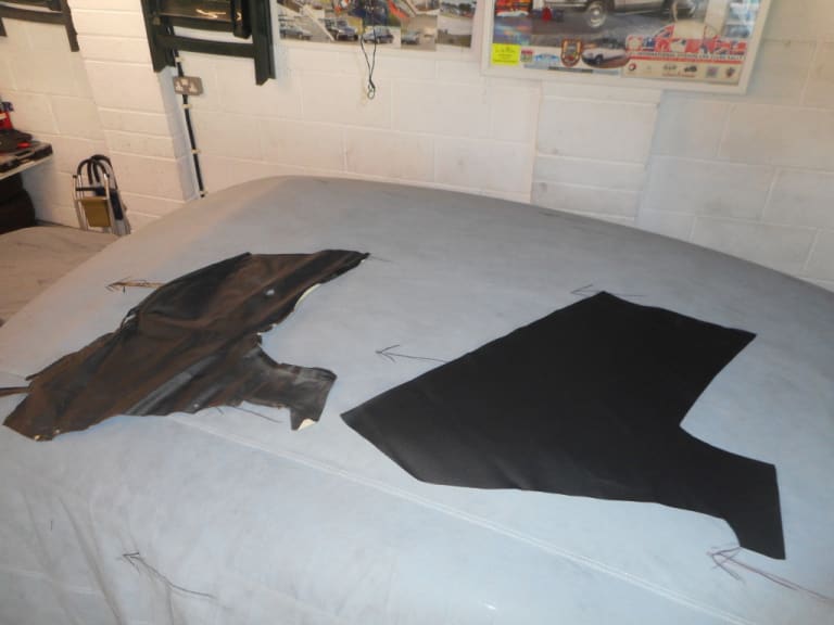

Finally the headlining was in place - I retrimmed the sunroof panel and am mostly delighted with the finish. One thing I did make a bit of a mistake on was the choice of padding material I used around the sunroof aperture. The original padding that was fixed to underside of the roof around had perished over the years. I therefore bought some replacement 7mm thick

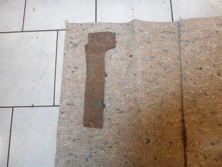

Car underfelt. I glued this to the underside of the roof using the remains of the old sections and templates. It was only after the trimmer had finished the job that I found that the texture of the felt was obviously a bit too rough - and it caused lumps to appears in the headlining fabric around the sunroof. I think it will settle down - and used some wood to gently flatten the felt under the fabric.
