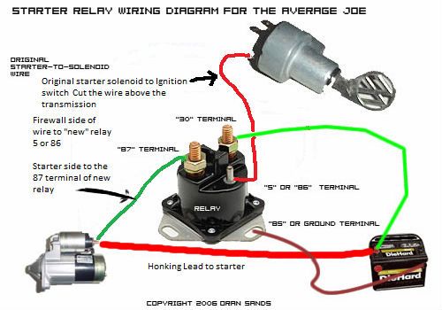

so today we removed the starter motor for a clean up, with a view to following the VW technical bulletin and fitting a relay to cure the heat soak / non start issue that apparently the auto’s suffer from.
Does anyone have a simplified wiring diagram for fitting this relay , that a bozo like me could understand? The VW bulletin makes no sense to me whatsoever…..
On the automatic starter or any other starter, you don't have to remove the starter.
Locate the RED/Black wire that runs to the Starter solenoid from the ignition switch. it is from the left and goes over to the starter solenoid. There is a White/Yellowed white connection in the middle of it.
Cut that wire in twain. Now you need to get a ford starter relay or any 40 amp relay. The ford starter relay uses a frame ground so it wires simply.
Find the two smaller posts and attach the red/black from the Ignition switch to the pick or little post of the relay.
Take the red/black that goes to the starter solenoid and wire it to one of the big honking lugs on the starter relay.
Take the other big honking lug, straight to the Positive side of the battery.
Attach the relay to the frame of the car this provides ground for the pick.
When you start the car the current flows from the Ignition switch to the positive post of the real pick, since the other side is grounded the relay will engage.
When the relay engages it will apply 12V 40 or 50 amps or more to the Solenoid which causes the starter to go wow, and engage every time no matter how hot it gets.
The ford starter relays that we have over here on 40, 50, 60, 70, 80 era Ford trucks are rated for about 100amps and only about 12 bucks.
You basically are taking the ignition switch and using its lower voltage wires, and using it to pick the Ford relay.
The ford relay reduces the run of wire from the battery to the ignition switch and back to the starter solenoid to the battery to the starter motor more direct, and higher current and lower voltage drop.

I Wired up a 30amp relay from the original red/black feed. Nothing!! Discovered that when the ignition key is wriggled in the ignition at crank position the live came and went, so now suspecting ignition switch….

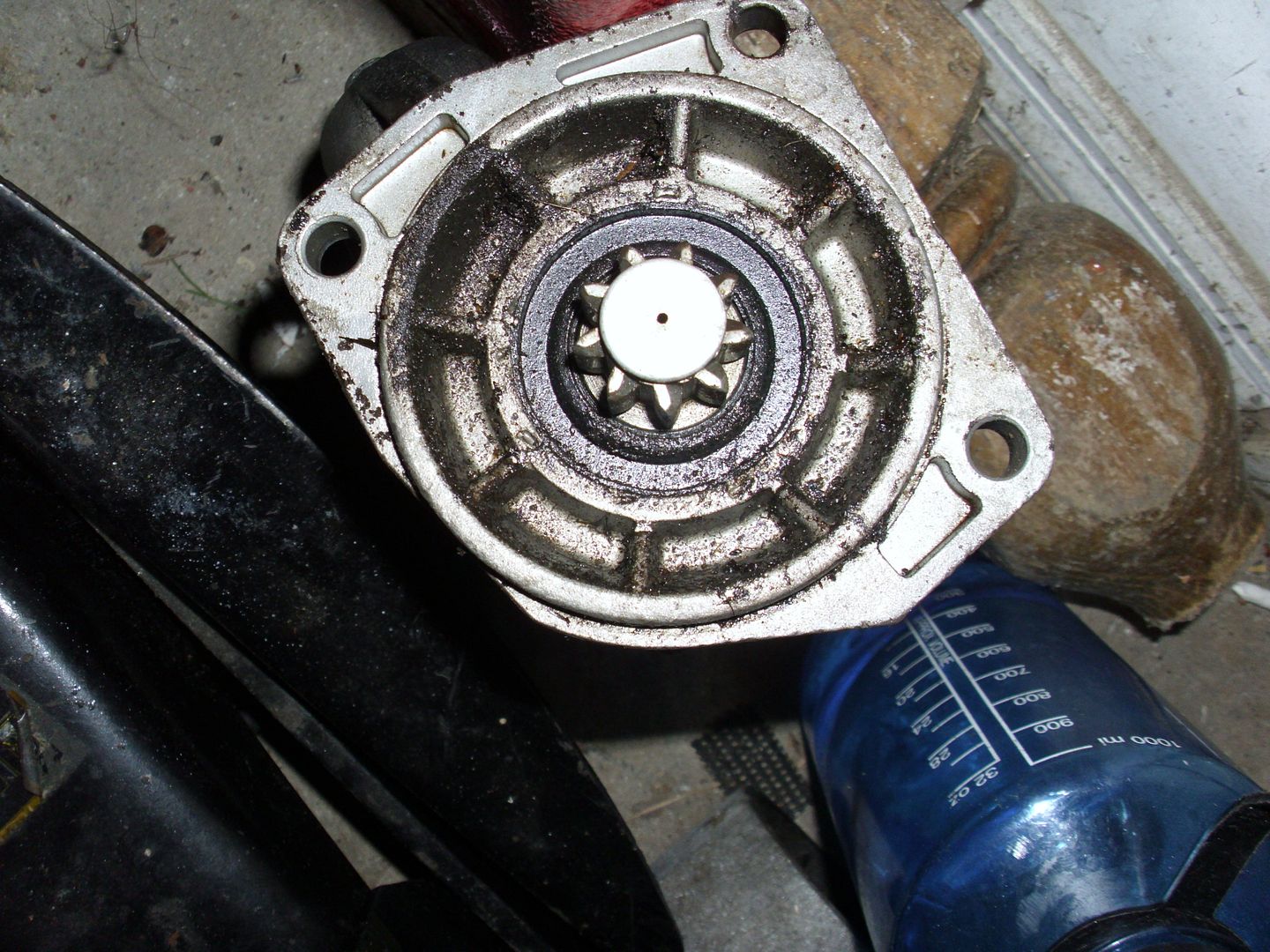

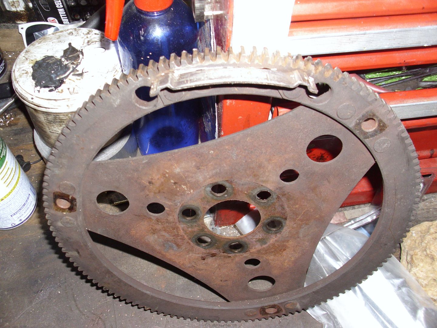

Spoked flex plate (late 89-93) usually

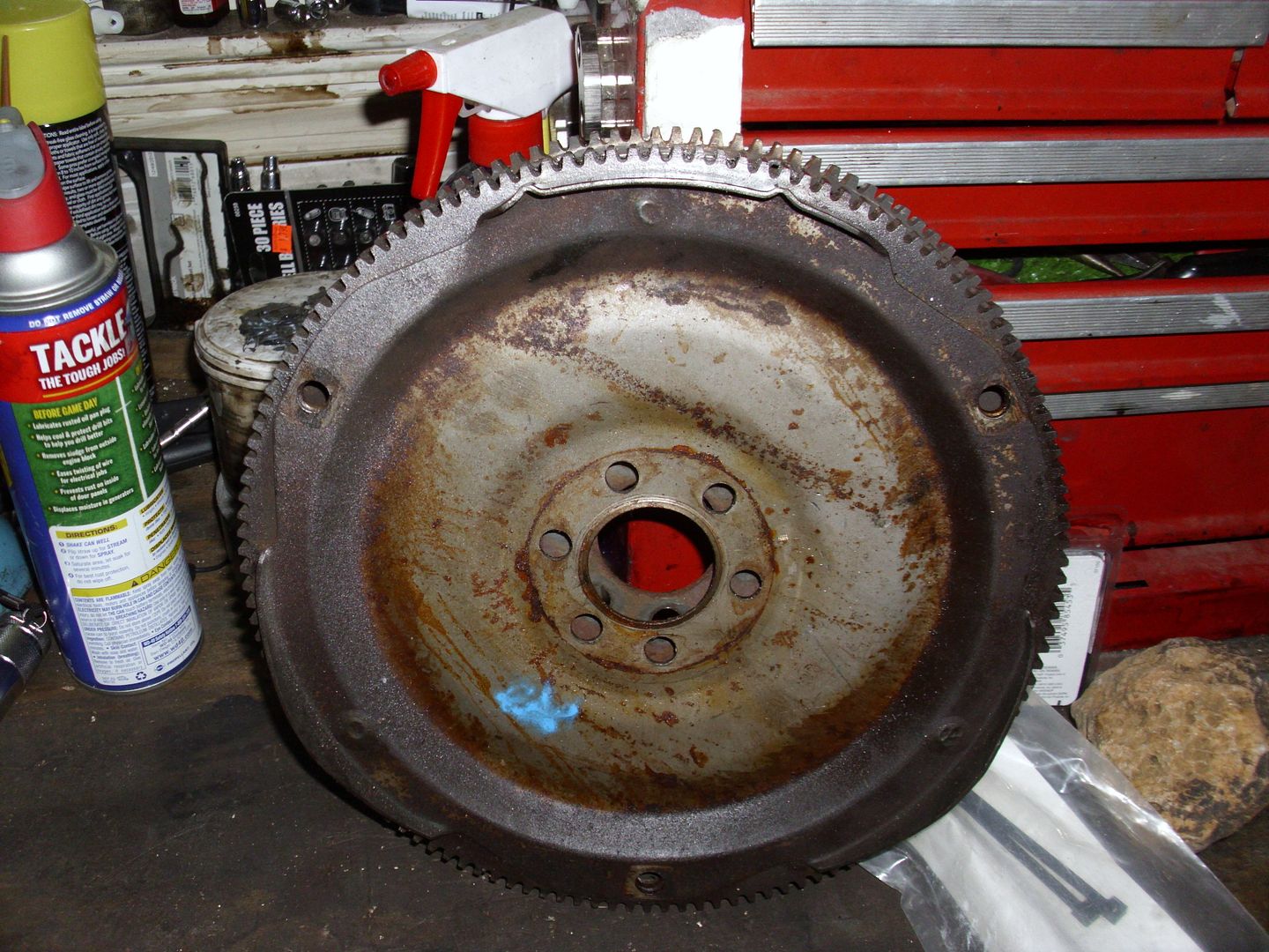

Solid
Solid flex plate starters:
Spoked flex plates have bumps in the casting in the circled areas..
Starters are not interchangeable getting the wrong starter for your flex plate as in solid starter in a spoked flexure can lead to stripped teeth.

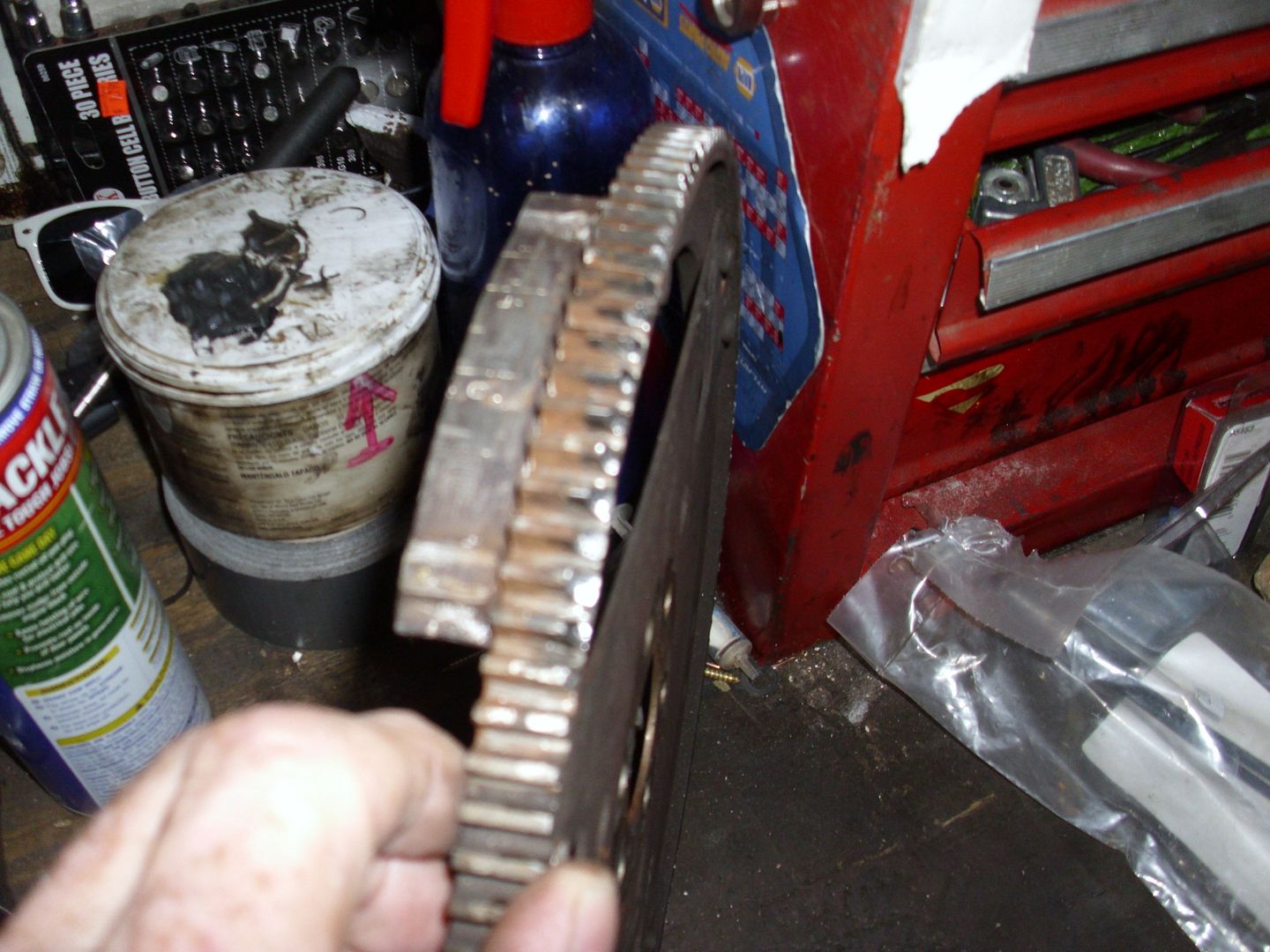

And if that happens as I had because of a Daughter and a trip to Baltimore that I didn't know of led to the Brandy new Bosch Spoked Starter replaced with a Solid starter and about 6months later 4 stripped teeth… As Flex plates are difficult to find I dropped the tranny and Welded the Flex plate teeth to fill them and filed them to spec, which lasted for about 8 months to allow me to locate a flex plate in the yard (solid off a 85 Cabby.)
They do make one that is 93 spec that didn't have the bumps on the casting so it can go either way, but alas I had the solid starter so I stayed with it.
Stripped teeth.

I've dropped the starter motor off at a specialist for a rebuild, I should get it back tomorrow or Monday, and yes, I'm getting good at R/R the starter, this time round it was laying on the floor in under 10 minutes LoL.

Rebuilt with a new solenoid, fitted and working TaDaaaa!!!
