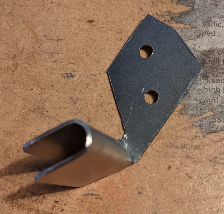

Got an immobiliser fitted and tidied up some messy dash wiring, fiddly, but it works. I was wondering where I could locate the immobiliser key-hole thing (not technically a hole, but you know what I mean) without making holes in the dash. I thought I'd see what was behind the blanking panel where the choke handle would be on, errr… cars with a choke. Turns out the hole behind it was a parfect size for the immobiliser thing, so that's where I put it. Sorry, no picture, I'll have to take one. So, got the main part of the dash fitted. Looks much tidier inside now!
Whilst going through the other dash bits like the under-dash tray bits, I noticed a bit of metal attached to the back of one, no idea what it was for. Then I noticed a plate riveted to the side of the fuse box bracket…appears that the two bits should be one….
Support bracket for the under dash tray then!
Knocked up a new one (as you do).
and got it riveted in place to the side of the fuse box bracket.

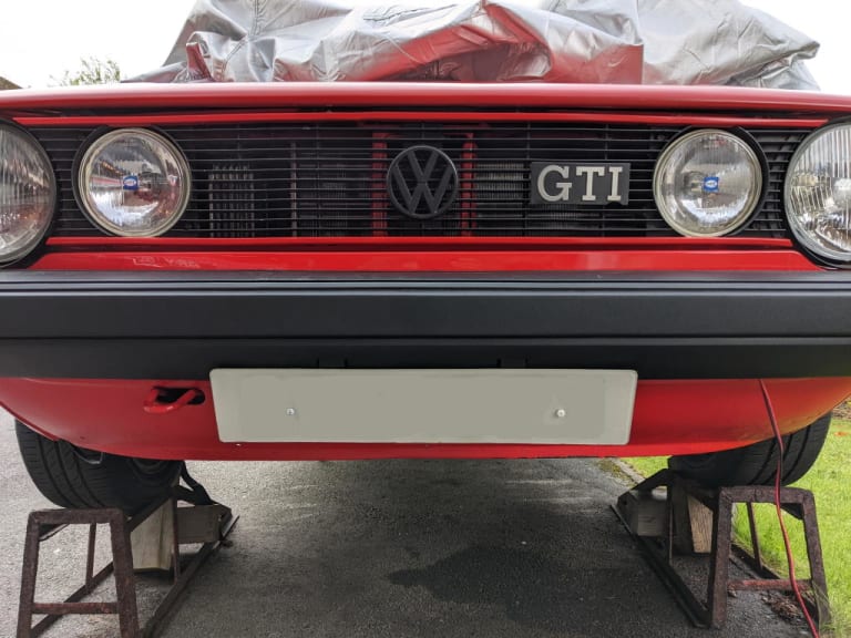

Whilst in the mood for bending metal (I can't call it fabrication!) I thought I best tackle the missing number plate plinth. After I got some pictures of an original one from cdgthreesalmons I started with some cardboard to get the bracket right….
And after some cutting, bending and rough welding (and grinding) I ended up with this:
I did have a fold along the bottom edge, but not being able to clamp the whole length in the vice, it ended up banana-ing the whole thing, so I chopped it off. Once bolted on to the bumper, it's rather solid. One benefit of making my own was that I could reduce the space between the plinth and the bumper (vertically) so most of the bracket that come through is hidden, like so:
All told I'm quite pleased with it.
