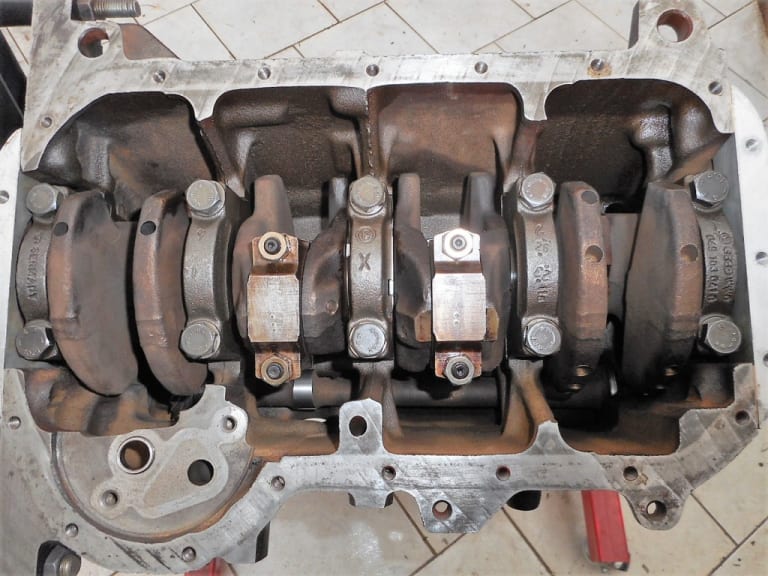

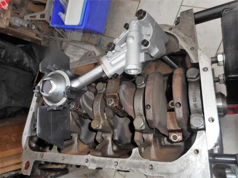

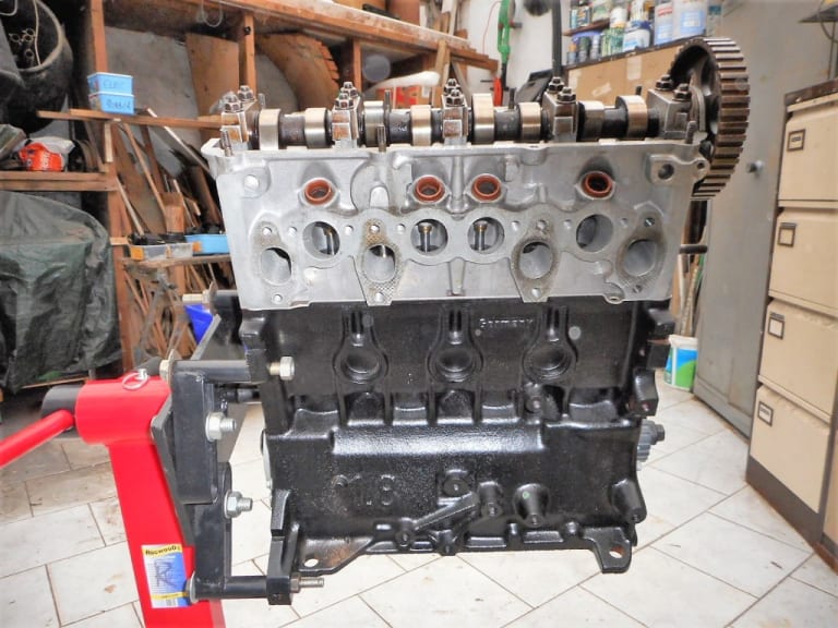

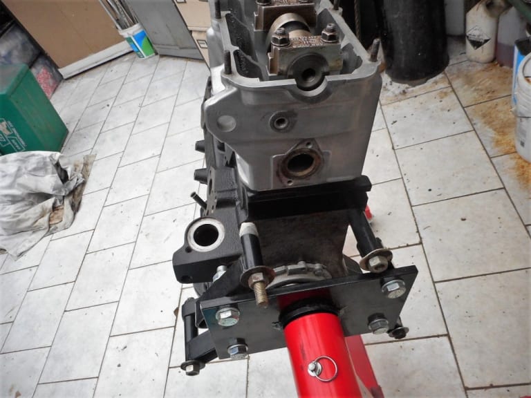

New Oil pump

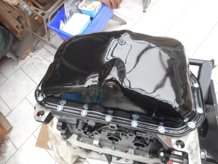

New sump and new socket head button bolts

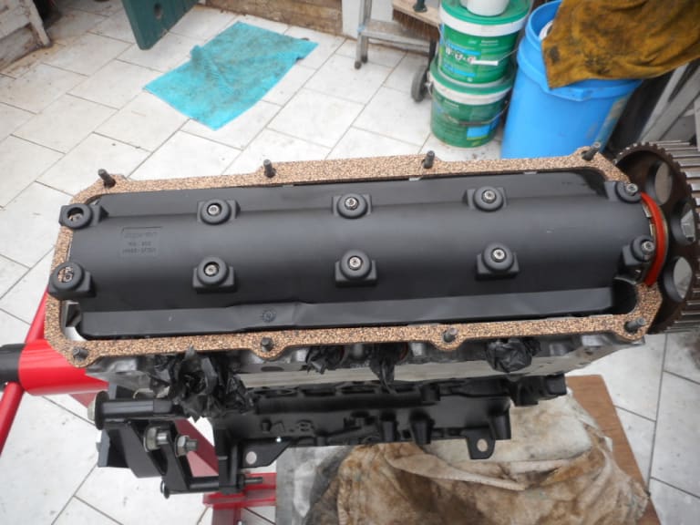

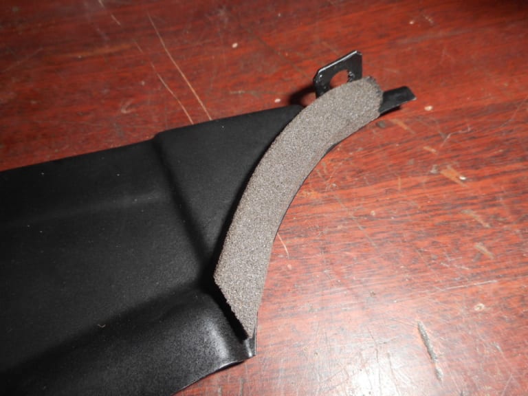

New oil splash guard and rocker gasket

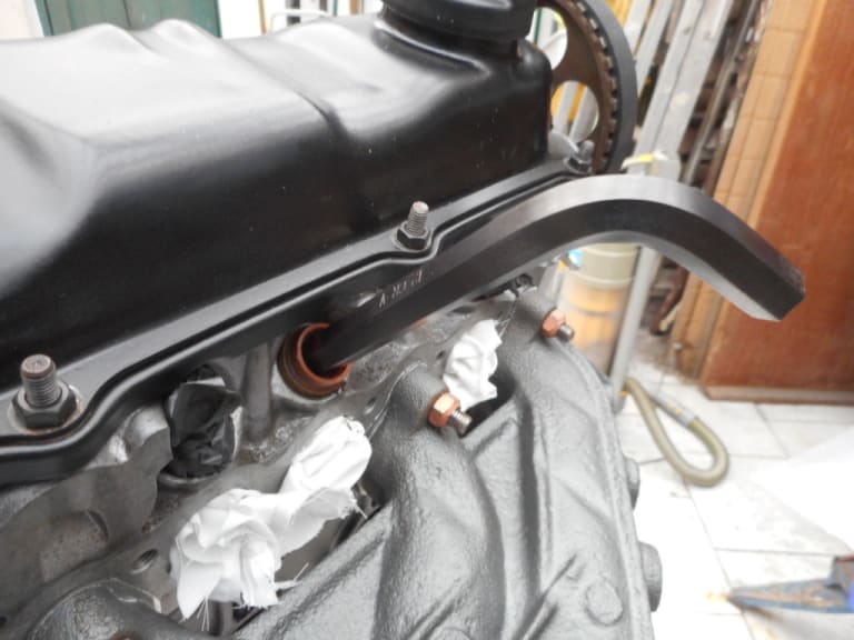

Fitting the Topran branded item below proved impossible due to warpage along the length of the plastic splash guard. No way the rocker nuts would have pulled down. Had to get a Febi item which fitted great.

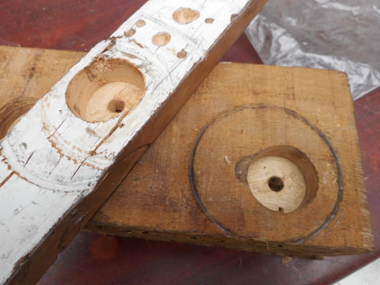

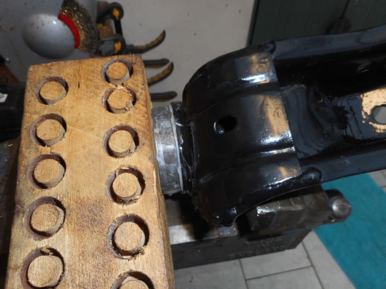

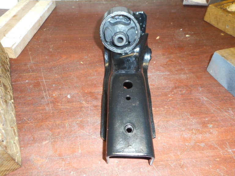

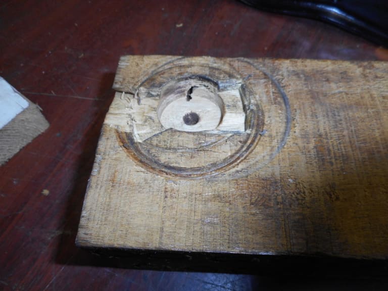

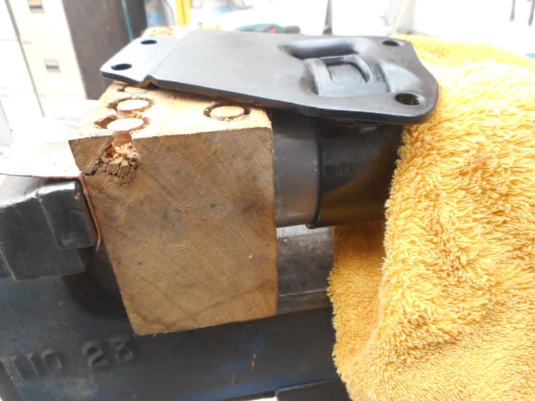

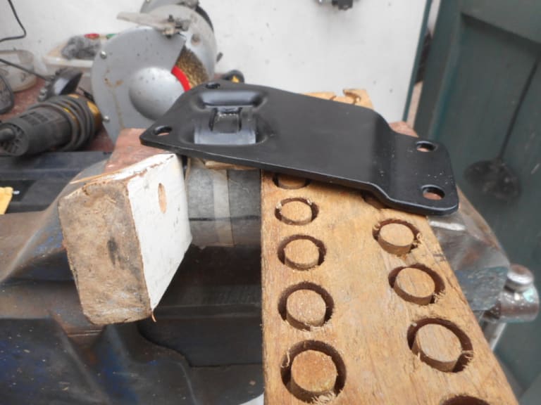

Used a block of wood with a large hole drilled out to allow for the protruding middle of the bush. Using a large vice and lashings of Vaseline I managed to get the bush in. For the last bit I had to use another block of wood, again drilled out to allow for the protruding middle. Worked well - but alot of leverage on the vice required!! Just proves you dont need a press to fit the insert - just some wood Vaseline and a good large vice.

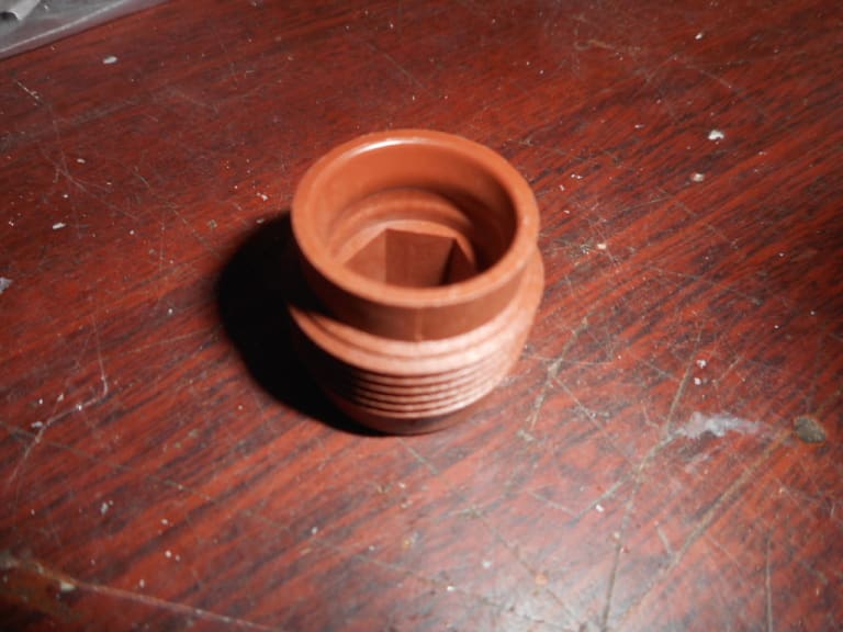

Before fitting it I had a debate on here and with others about the orientation of the rubber bush insert. The bolt does not pass through the vertical centre of the bush, so if fitted the wrong way up would mean the engine either too high or too low. I eventually confirmed that the bolt hole is at the BOTTOM of the support - with the gap in the rubber uppermost. I was surprised at how little info there was on this matter. Only one small photo in Haynes mentioned it. I reckon there are quite a few fitted incorrectly out there!

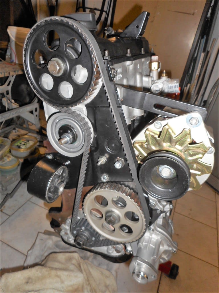

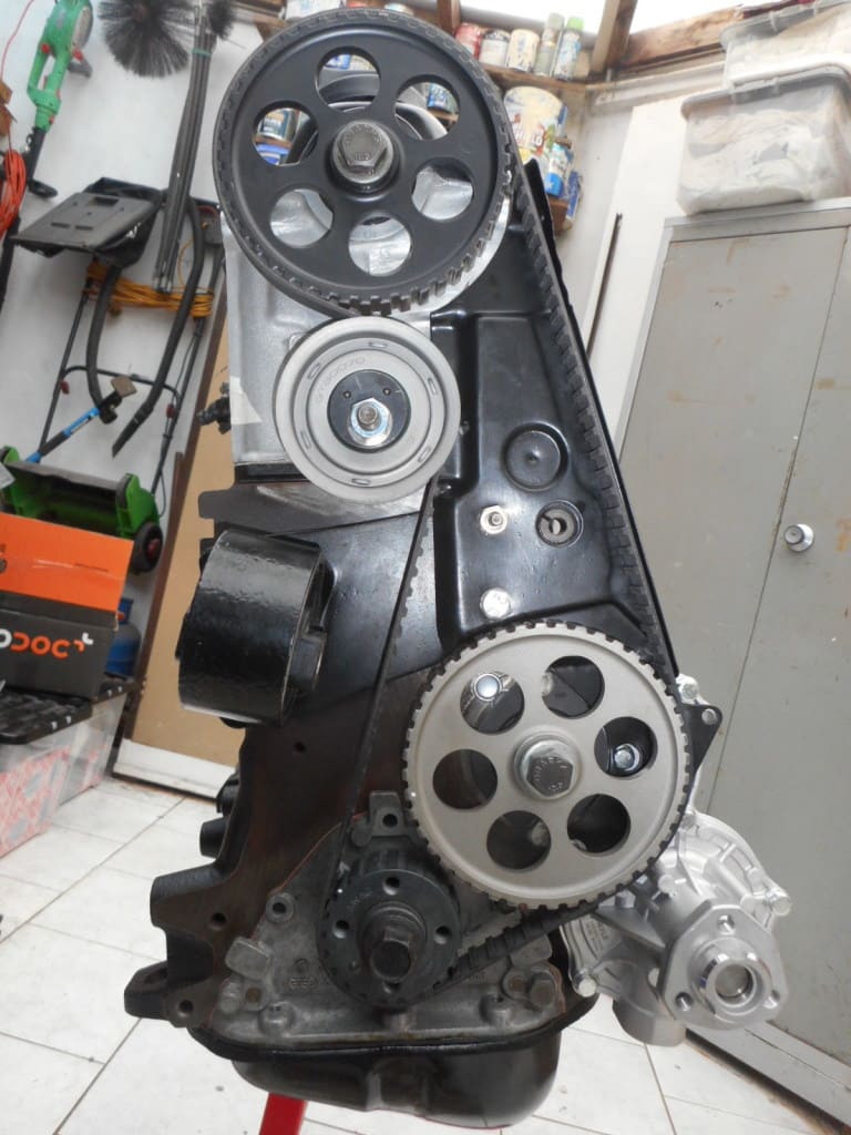

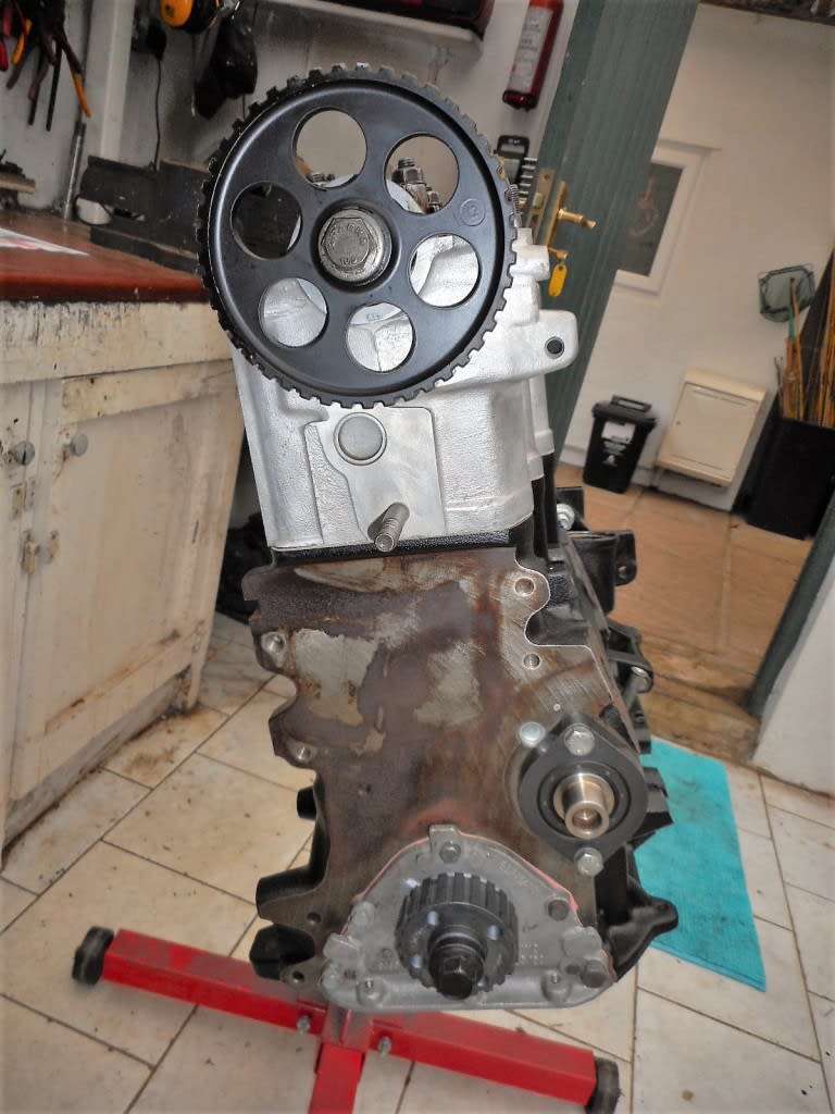

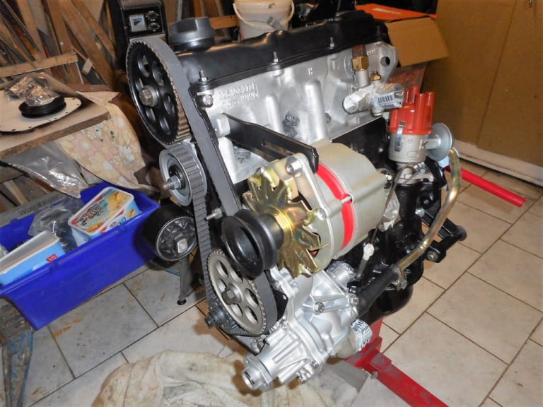

Cam belt fitted

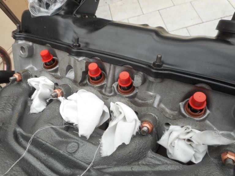

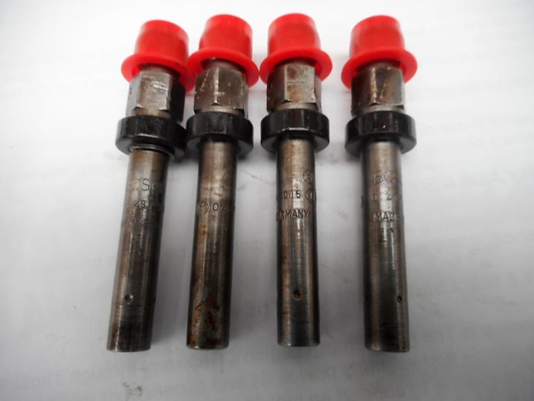

Injectortune - Ultrasonic fuel injector cleaning by Post.

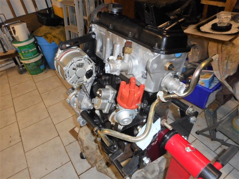

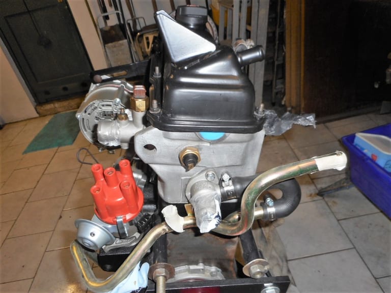

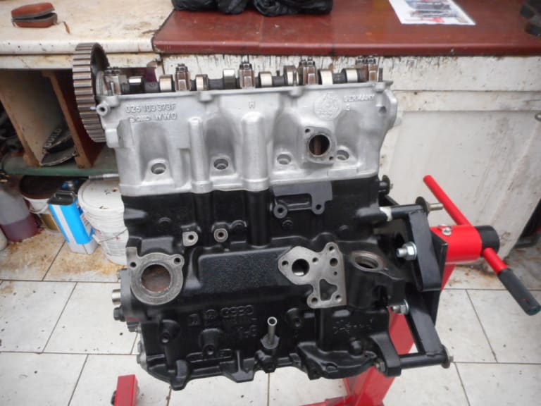

Beginning to look like an engine once again!

I admire your persitence with the engine mount, I tried doing mine in a vice but it wasn't going anywhere. Took it to my local mechanic, and for the price of a couple of bacon sarnies, he pushed it in on his hydraulic press.
Need to do the same with the gearbox side one now I've found it!

Saulty said
That’s looking really good Guy. Where did you get the new sump from?
I need to get across to you sometime soon and see how your getting on.
From Heritage I think. I've had it n the shelf for ages!

Thanks paceman. I was on the verge admitting defeat with the engine mount bush but then it suddenly started and in it went.

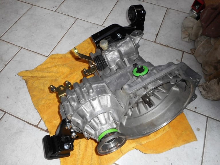

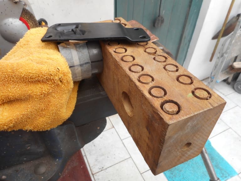

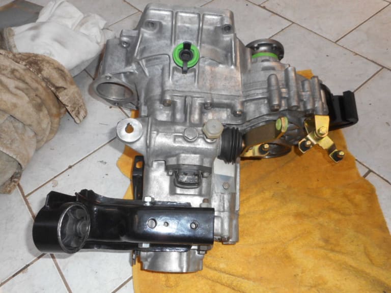

Just finished the gearbox side this afternoon. Proved harder due to the fact that the mount isn't so easy to get in the vice due to it's shape. The main issue was that the rubber bush insert protrudes in several places - not just the central bolt hole. I had to adapt a piece of hardwood with recesses made using a drill/spade bit so as not to damage the insert when pressing it in.
I felt so chuffed when I'd done it!
Until I realised it was upside down! Some choice words were uttered! Thankfully due to the Vaseline lube it tapped out remarkably easily and without any damage…… before fitting it the correct way up!

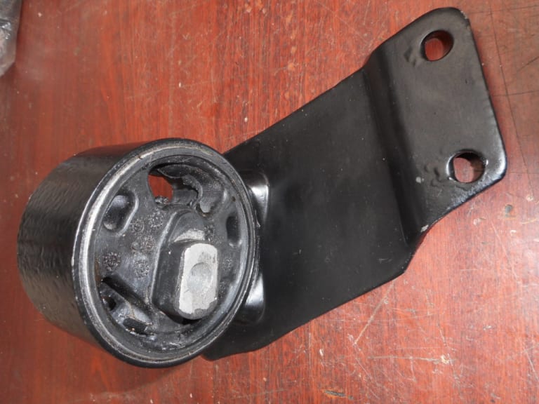

As explained above this mount was more tricky!
thumb=

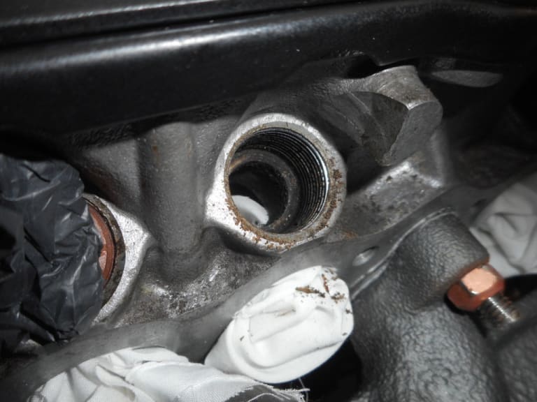

Need a 12mm Allen key for this.
One of them was so very tight I have left it in situ for fear of rounding off the socket hole and creating a whole load of trouble!! It is not split so am happy to leave it alone.
Plenty of muck after removing the insert. Vacuumed out and then cleaned the hole before refitting.
Temporarily fitted renovated brackets.

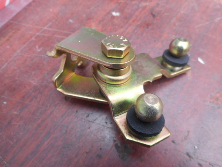

Nicely plated gear linkage parts with new bushes.
