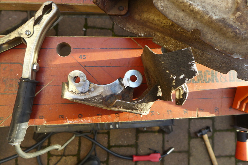

While I had the welder plugged in I quickly added a couple of washers to the hanger bracket as the holes were rusting through;
