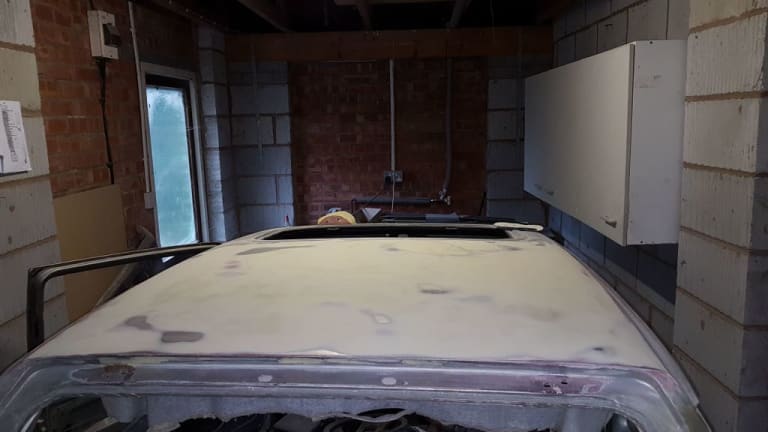

After buying the p slots shown above i ended up bare metaling the roof for the second time as surface rust had started under the etch primer
The filler shown here was also removed and the entire roof skimmed as it had became apparent someone had walked across the roof at some point, this does need final finishing but will be finished when the rest of the car is prepped properly for primer.

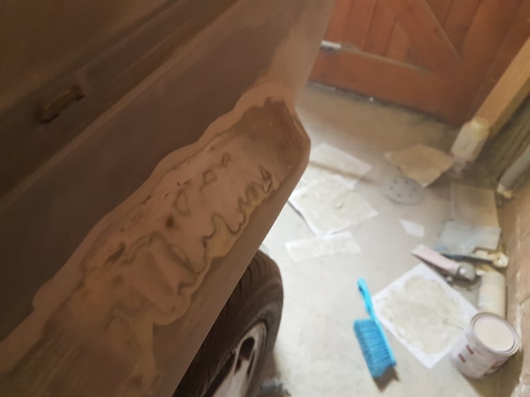

Then it all started to go wrong, seriously wrong, I was about to finish working on the car for the day when I noticed something strange about the rear arches, the profile seemed off, too rounded to be normal, a closer look revealed filler, i thought this was a little weird as the arches had been replaced before i bought the car so i had a little sand back and got to a patch of filler that hadnt hardened, naturally it would all have to come off then, this is what i found
Looked to be all intact so i removed the rest
That line shows how deep the filler was on a seemingly decent arch, ok it had a few little dents but nothing needing that much filler, i was left feeling uneasy about this but decided to carry on flatting the side of the car back and noticed a high ridge on the rear quarter panel, you should be able to make it out in this picture, the bare metal is the high spot
The high spots carried on all the way up the quarter around the filler cap too, only one thing for it then bare metal again this revealed the true depth of the filler as seen here
You may be wondering what all that was hiding, well the answer was the worst welding welding I've seen on a body panel of a car that was meant to be a show car, i feel for the previous owner as hed paid for someone to do this and the filler work

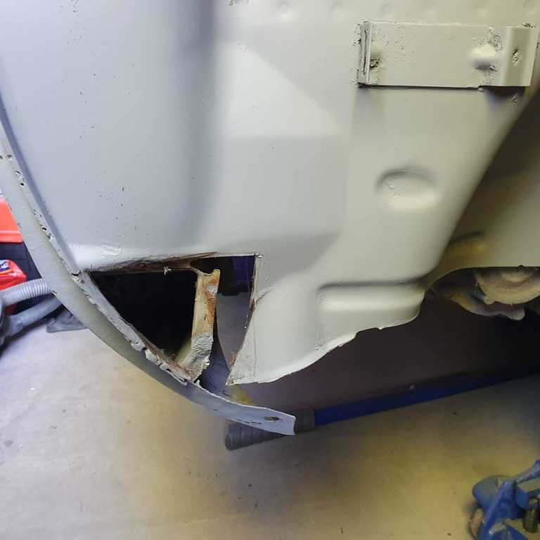

Long time no update on this, genuinely wasn't ever expecting it to take 2 years to find a useable rear quarter panel, so although some work has been done the car isn't as far as it should be.
Since the last instalment I moved back to the front of the car to prep the bonnet and found the paint could be scraped off in sheets, this meant going back to bare metal. The ns inner wing was cleaned back and primed as well as having a weld repair to a small area of rot and the bonnet primed back up. Looking to complete all of the front sub frame and suspension next so can repaint the underside with it all removed and have it as brand new going back together.
Does anyone know which spec shocks and springs would be standard for a 1.6 gti? I want bilstein but not sure if there's differences between the gti and normal golf's.
Pics show some of the work carried out and thanks for any replies regarding suspension.
