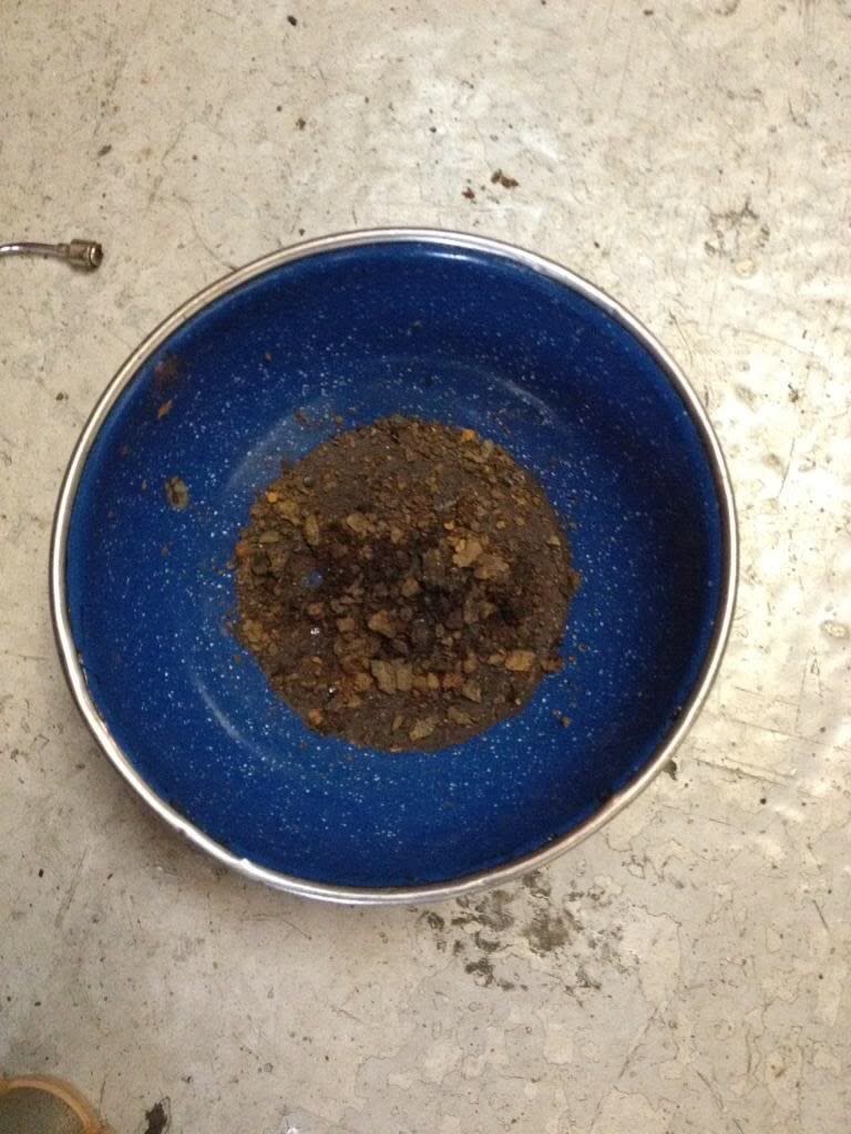

Running home last night after the Wheeler Dealers meet,  round the end o the M65, nearly there… Judder, judder, judder as I went round the roundabout!!!As if I need reminding!!  :P
Ha dthe MOT and service done at Bert s in May. Today when I was driving round the same roundabout - nothing!!! No juddering etc at all and I was just under 1/4 tank.
Perhaps this lot had something to do with this!!!
 We fished quite a lot of rust out of the tank, probably left over from when the previous owner did the filler neck. The bottom was also 'hoovered' with a natty device made up of a tube, flier and a fuel pump. The other side of the fuel pump had a hose that went back into the filler neck to complete the cycle!
We'll see if that little job solves the problem.

any details on the 'device', custom made or was it something you can buy?

It was made by Bert himself.
Length of small bore petrol pipe connected to a filter - a large one and then a fuel pump connected to a car battery and then a length of pipe out of the pump long enough to reach the filler neck again.
The small bore pipe ensures that it could be aimed at specific areas in the pot.
Once the pot was 'hoovered' out the new filter was put n the car in the engine bay.
The old one had a lot of sandy rust in it. It must have helped getting rid on all that!

sounds simple enough, will bear it in mind if i ever need to hoover a tank :lol:
VAG Documents & Downloads
It was very simple but effective! It's a wonder that one isn't more widely used.
