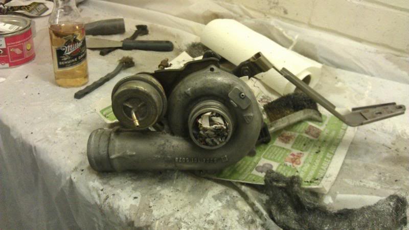

This arrived the other day Which has changed plans a little.. for the best of corse Got carried away with the wire wool and took the stamp off, lol as long as it does it's job
