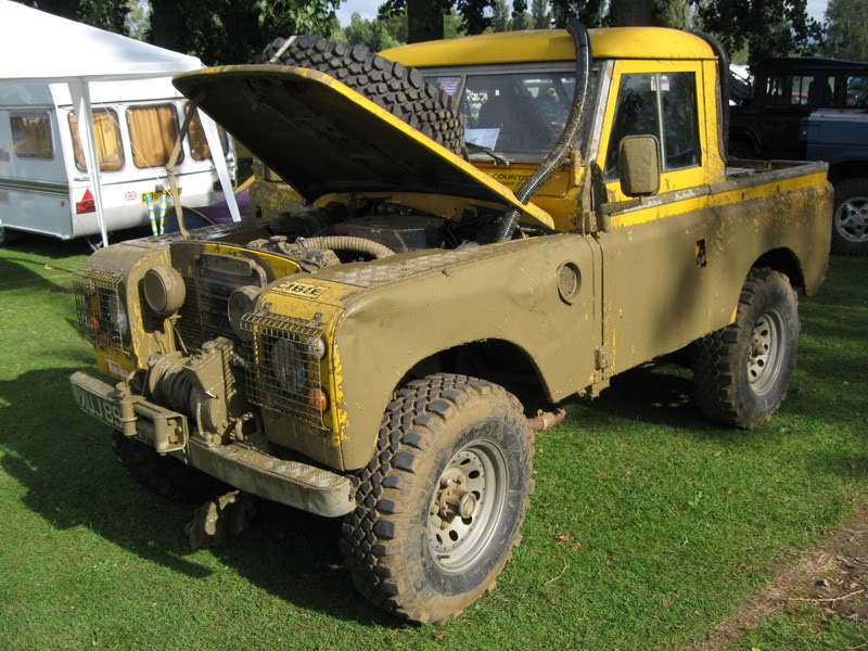

Its a 1972 Series 3 rocking a Ford 3.0V6 essex engine from a Granada.
I've owned it for 10 years and have slowly modified it from a worn out farm hack to what it is today - a worn out farm hack!
I probably should have put my efforts into a coil sprung 90 to get a far more capable vehicle far less hassle but I have a soft spot for the leaf sprung landys.
Apart from the non standard engine it has various other mods necessary so not to embaress yourself at off road events.
The trump cards are the front and rear hydraulic winches which are original Landrover items from the 1960's. They have a 4 tonne pull and will pull the landy out of anything. Not the fastest but when all the other electric winches around have over heated these will just keep pulling.
A couple of years ago I converted it to Fuel injection using a megasquirt ecu and other parts salvaged from various cars including the throttle body off a MK1 GTI!
The reason for going this route was finding that winching up near vertical surfaces caused the carb to flood and cut the engine which left you dangling on the winch cable.
Early stages of fuel injection conversion including a full rewire of the whole vehicle and a new exhaust fabricated by yours truly!- (There was over 35hrs put into those stainless exhaust manifolds alone!)
New wiring being fitted into custom dash….

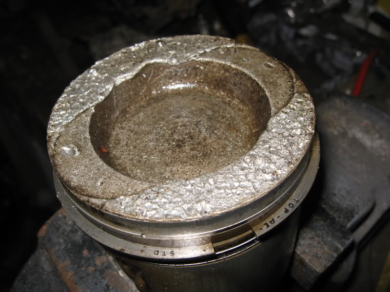

Its been a bit of a trial and error type of mod and unfortunatly my last experiment went wrong.
I wanted to restrict the amount of air flow into the 2 middle pots as the outer cylinders were getting starved so I made a baffle which fitted inside the inlet manifold. Unfortunatly the baffle broke up and went through the engine destroying a piston, and damaging a valve seat. This was back in the summer.
Last month I finally decided I needed to sort it out ready for the winter so off came the heads and sump to see what was going on.
Fubared piston….
The bores were fine so I have re-ringed the engine along with fitting a good replacement piston.

Anyway a couple of action shots to be going on with! I don't have many as its not on the top of your list whilst trying to navigate various obstacles!
In deepest South Wales….
Billing offroad course 2006…
