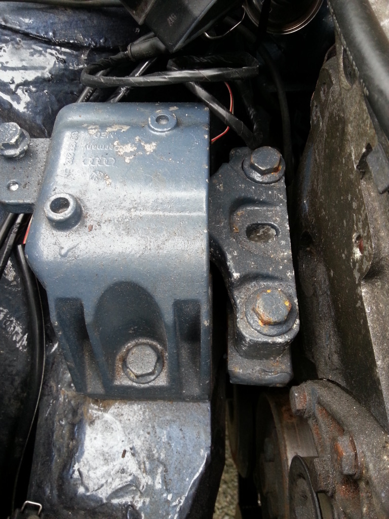

I see that you have the mk4 mounts. Do these connect to the mk1 mounting points or do they need to be welded into place?
I think they are welded onto the chassis legs, i'll take some photos for you later when i get home.

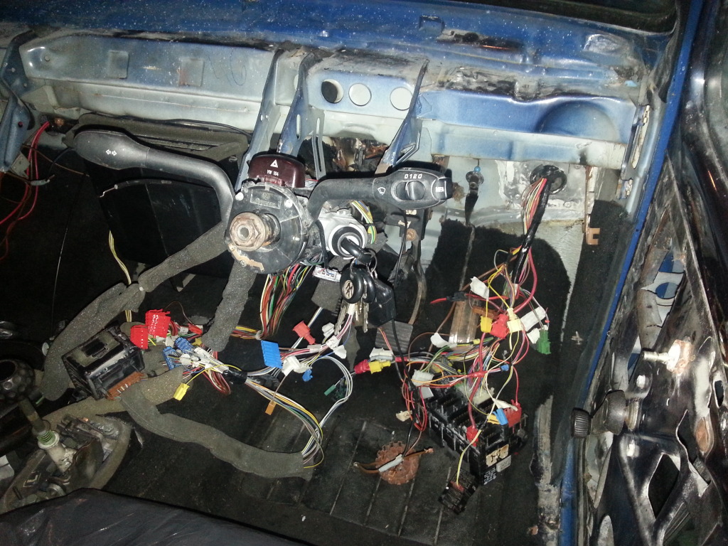

Had to start with these bits so that i can get to everything in the back, before getting stuck into the wiring, which is ok i think, the VR6 clocks sort of work!! Indicators, hazards and headlights work and show up on the VR6 clocks, but it doesn’t show the battery sign and occasionally shows the mileage. It also sounds the oil buzzer when the ignition isn't primed when you try an indicator, but i’m looking to move the fusebox to the standard passenger side so will have to get lengthening and checking the wires as I go before trying to fire up the engine, i don't want to blow the ECU. I can also wire in the diagnostics cable i got this morning.

The VR6 clocks are in the car at the moment, which are acting weird, hopefully when i get the wiring sorted these will work properly as well. The mileage and clock appear occasionally but if they do they disappear as soon as you turn the ignition one click. The indicator, hazard and headlight lights on the dash work fine, but the battery one doesn't work. I'm hopefully going to swap the clocks for another set just to eliminate them which will hopefully narrow the problem down, but i reckon it's a bad earth possibly or something related to the ECU not being found by VAGCOM.

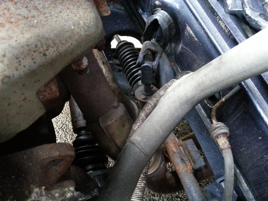

I took the radiator out and had a look at the connections on the alternator which wasn't good!
The main connection to the starter motor won't undo anymore as the alternator case is cracked and the blue exciter wire connection point just fell out!!
I looked to see how hard it would be to replace as i've heard it's a front off job on a MK3 VR6, but struggled at the first hurdle. The tensioner has a threaded hole that you put a bolt in the release the tension on the belt. I'm not going to be able to do that as i only have 1/2 a hole

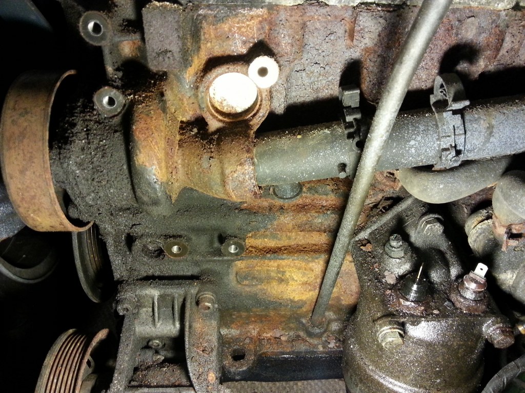

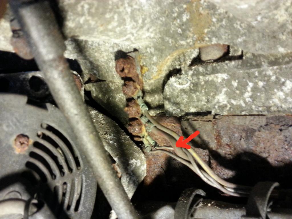

I then found the main earthing point on the block which i think might need cleaning up a bit. The main thick wire which connects to the second contact in the picture looks red to me this morning, but i'm going to check when i clean it all up as my eyes might have been too cold to carry on by that point

I've ordered a 6pk1105 belt to replace the one i had to cut off. This won't fit at the moment, but hopefully will once i get the power steering pump off. I'm a little worried about the state of the engine block. Just touching the block has made chunks of rust fall off, but i think with a good wire brushing i can clean it up and then give it a lick of paint, that can wait until the car is running and then i'll take the engine out and give it a good service.
I've been having trouble getting VAGcom to connect to the ECU. I thought it may be the ECU and as luck would have it an exact replacement came up cheaply so i got it. At least i now have a spare if it is dead. The electrics were a bit dodgy as the lights, mileage and clock on the dash wouldn't work then appear then disappear again at will. I suspected a dodgy earth (notice the block!!)
The earth point on the front of the engine block looked pretty bad
I quickly hooked up my new 2nd hand alternator to the starter motor, and bodged a quick earth for the loom to the negative terminal on the battery and just tried hooking the battery up to see what the dash did and it has solved my dash problems. I now get the oil and coolant warning lamps as they are both unplugged, but more importantly the clock and mileage stay put, and don't disappear if i try the indicator or similar
