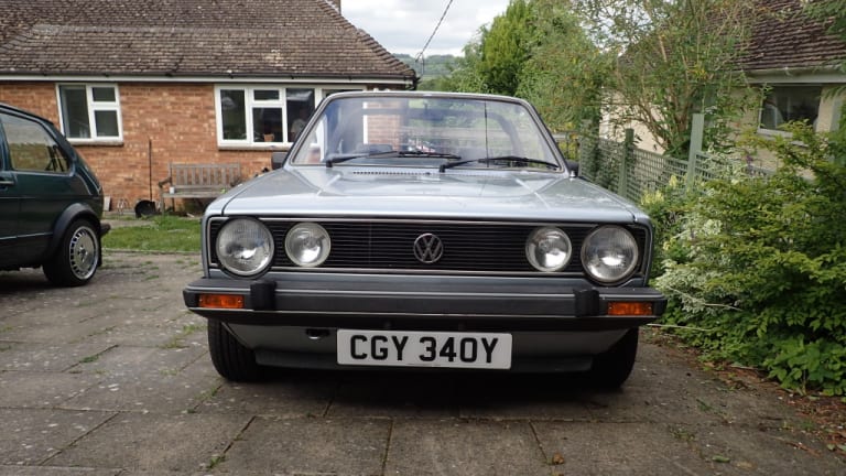

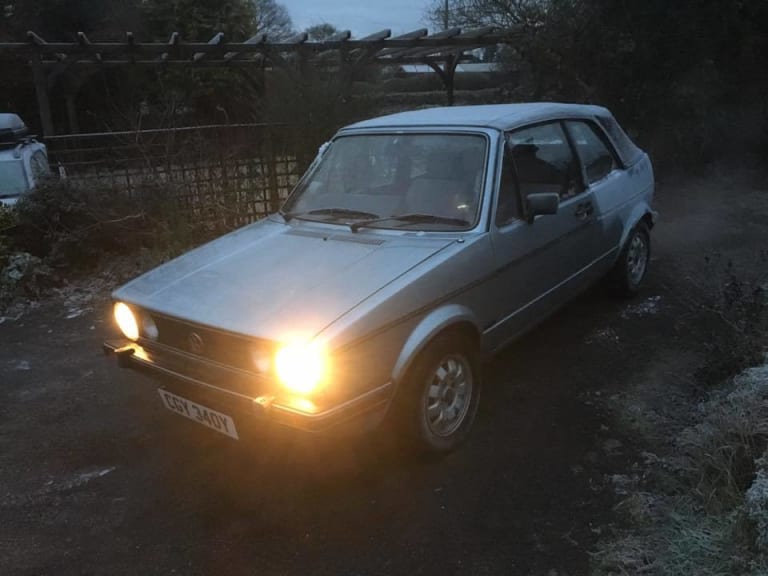

So the listing for the car was pretty poor with out of focus pictures and a weak description, but seeing as I was looking for a light project took a chance on it.
Well the car was delivered to me by a chap that I used to transport my tin-top, thanks Arek. I was pleasantly surprised when it arrived although Arek informed me that it wouldn't start, although it was running when he picked it up! Anyway to cut a long story short and after a week of checking various things the fault turned out to be the connector to the electronic ignition module.
The car has been off the road for 11 years but stored in a garage and started every year. Apart from a few little storage related dings and after a bit of a polish its come up pretty nice. The drivers seat is a bit torn so I hope to get a replacement cover for that otherwise it will be just a case of getting her through an mot and then just enjoying it.
Here's some pictures

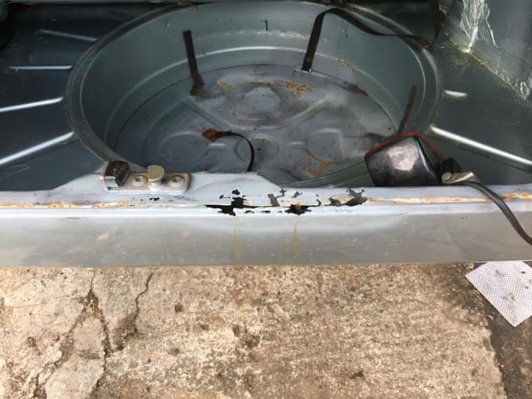

Sadly when I was replacing the brake lines next to the fuel pump that I had removed I found my first bit of serious rust, damn, I was so close to getting the car MOT'd as well, the side of the rear chassis bracket where the rear axle bolts to had a nice rusty hole in it, right next to the fuel tank.

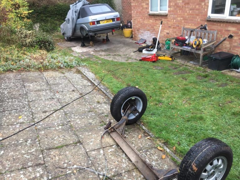

After consulting a local welder we agreed that the fuel tank was going to have to come off before a repair could be carried out. As you may well know to get the fuel tank off the exhaust and rear axle have to come off, and so here was my next challenge. To save myself a lot of money we agreed that I would strip the car down myself and get it ready for welding.

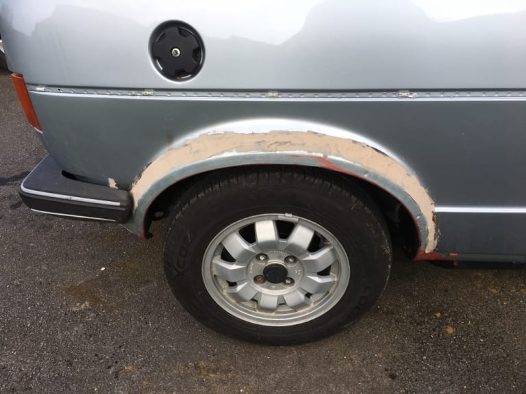

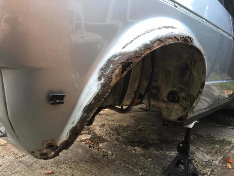

My welder wanted £90 a hour, ouch, and said that I should look around for any other rusty bits that he would sort at the same time, I knew there was a bit of bubbling around the offside rear wheel arch so next job was to remove all the arch trim and this is what I found.
Fortunately this was the worst of it a new inner and outer arch required, other than that just a few patches were required here and there, apart from the lip on the tailgate strike plate which also was quite bad.
Whilst the rear beam was off I decided to give this the POR-15 treatment as well, and then it was a case of re-assembly. As I had the tank off I decided that it would be best to flush the last of the rust out with water and the left if to dry in the sun for a week or so.

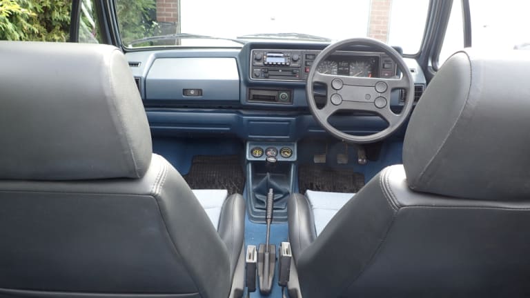

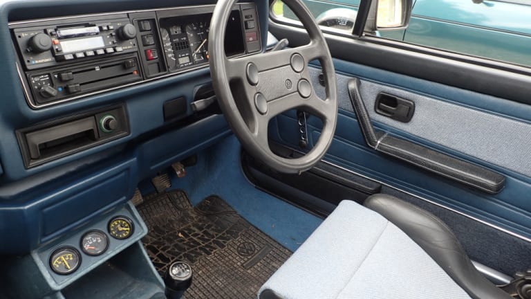

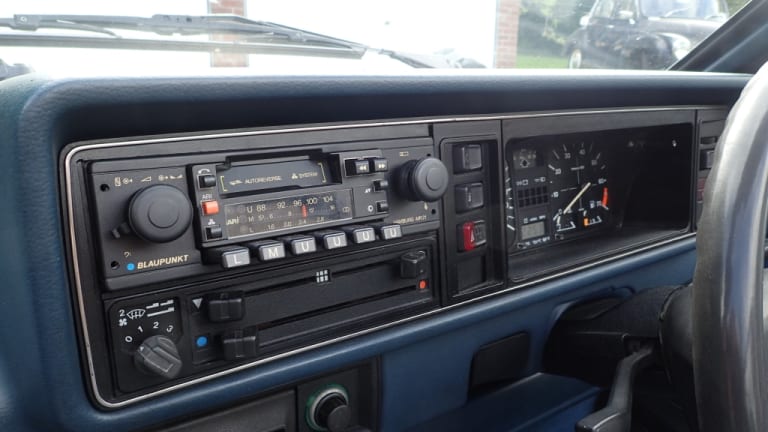

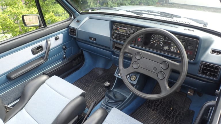

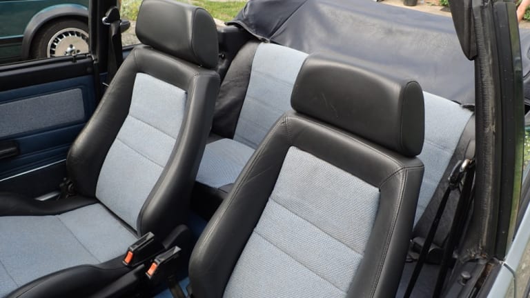

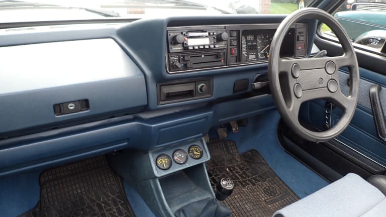

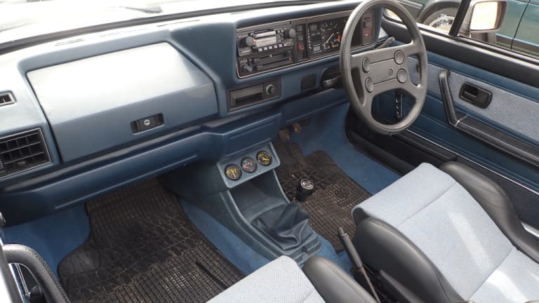

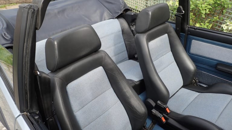

I then refitted all the trim, a electric aerial, Blaupunkt stereo and Pioneer speakers. Whilst I was waiting for my paint job I stripped the door cards off, the front cards had been badly damaged by water and were warped. I decided to strip the vinyl off the old hardboard and remount it onto new board as I wanted the car to look as OEM as possible. Final job was to sort out the seats, I picked up a set of Rover Recaro half leather seats and have retrimmed the inserts with original VW fabric. The rear seat I have made a new cover for out of vinyl and the same fabric.

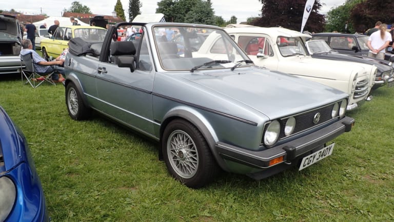

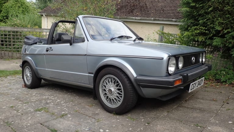

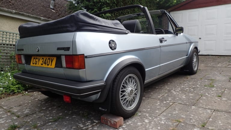

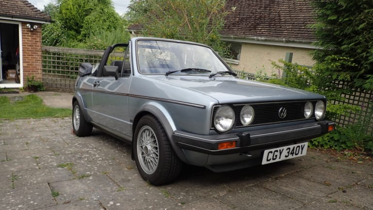

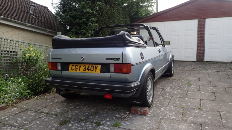

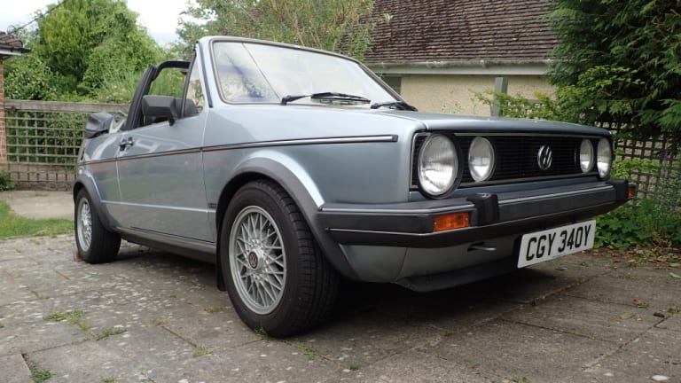

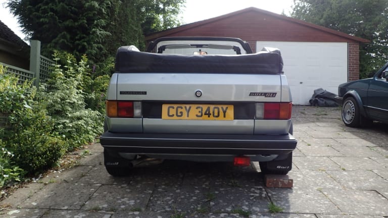

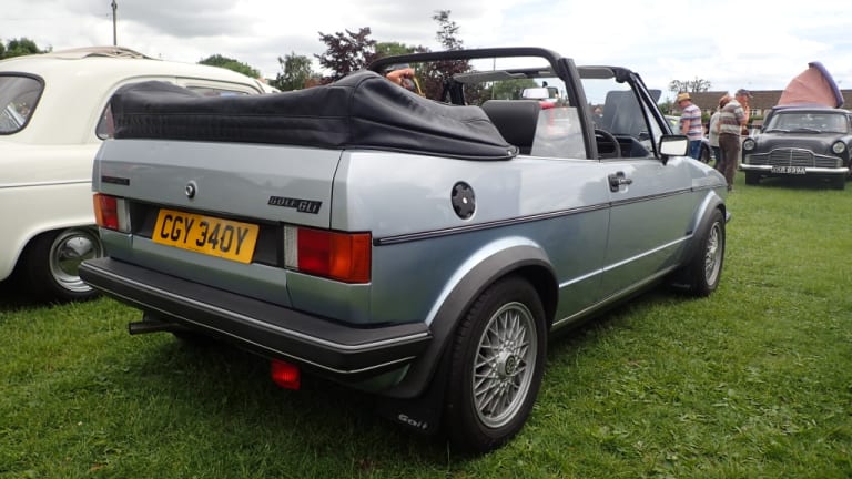

Anyhow here's how the car looks now.
