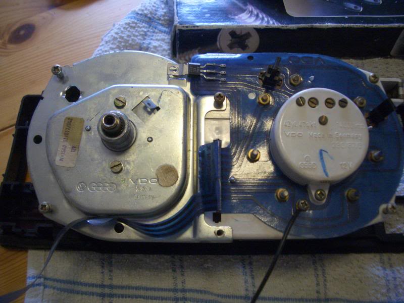

One thing I didn't mentioned was that a previous owner fiddled with the writing on the print.
I didn't mentioned it because I drove the car for quit a few years and never had any problems with the dash. So in my understanding the problems I'm now facing can't be related to the weird things he did.
But weird it is …
He soldered a wire from connector nr 1 to connector nr 12. On this one should be a diode, but it's gone… Probably broken off when disassembling the dash.
What is weird however, I can't find what position 12 is about, but I know position 1 is for the lights in the unit… So the current being put to position 12 is 12Volt and when I would play with the regulator that current is being lowered … So this can't really be healthy for the dash I assume…
Can anybody tell me what position 12 is used for? And even better, what type of diode supposed to be in here?
That way I can buy a new one and fix it as it should be…
Thx!

Is yours the same dash as mine? Must be my old eyes, but I can't relate your pictures to my type of dash… ?
Ok, so I cut the yellow wire to test the difference. When I now turn on the contact the oil lamp won't start blinking, so I assume that the oil warning won't work either. Furthermore it don't seem to make a lot of difference.
Unfortunately it didn't helped me on the clock/board computer problem, this stayed the same…
I also dismounted the connectors on the Mylar (both of them) to check, they actually seem to be in very good condition, everything nice and tidy, I don't think they are the problem either…

Sorry can't be much help on other stuff.
This is mine.

Drill a small hole between the "X's" and sand a clean spot along with a self tapping screw.
To ensure that my connector is tight and the pads are meeting the pins
Carefully remove the Shroud off the connector.
To expose the Mylar sheet covering the plastic tongue.
On the pad side of the tongue I use one piece of vinyl 3m tape.
Replace the mylar and the shroud.
Stopped a lot of flakiness in that connector and tightened it up.
