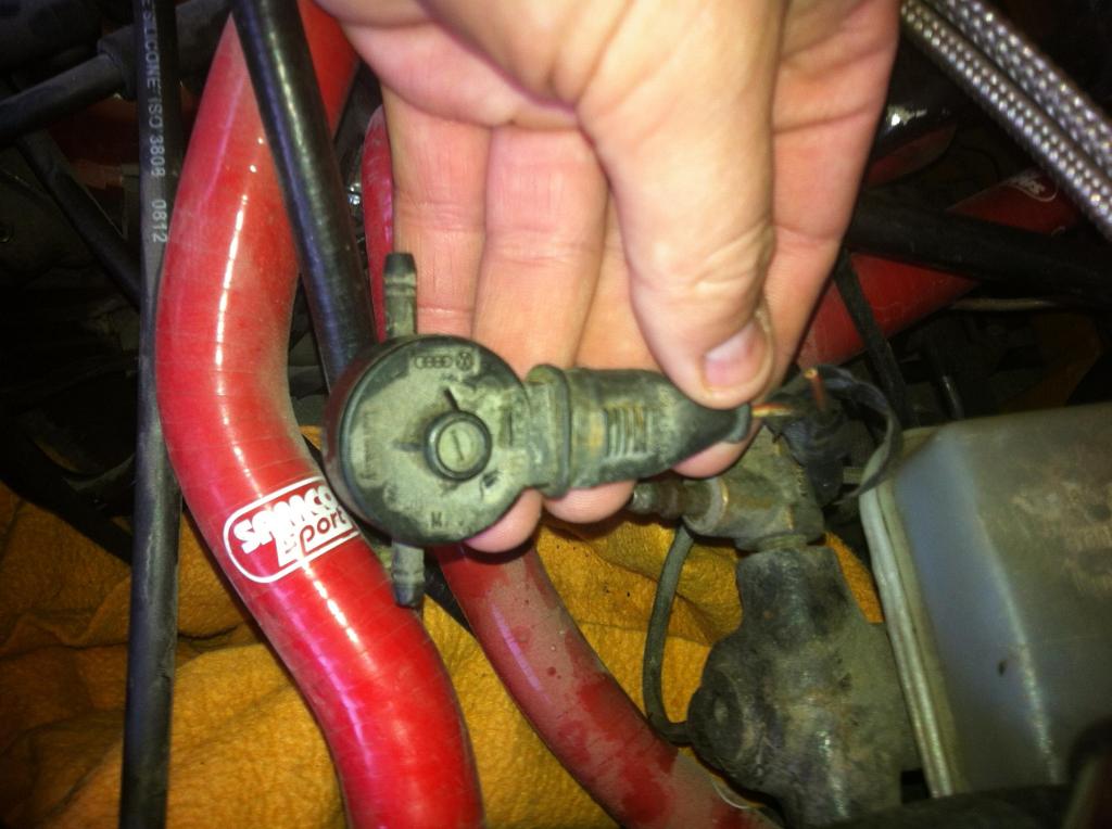

No idea what this is or what should go to it
Any help much appreciated

the switch above is for the shift light, it should be plumbed inline with the vac hose to the dizzy.
