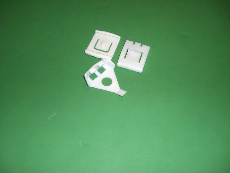

I've replaced the nylon sliders on my front seats (the 2 bits that go into the seat runners and attach to the legs at the back of the seat base). These move a lot better now and are solid but there's still some up and down play at the front of the seat which is just held by the peg on the adjuster handle.
The kit had a couple of half-round rubber bits in with a rectangular lug on which I was told fit on somehow for the front of the seat to rest on but I can't figure out how they go on.
Has anyone got a picture to help out or could you even just describe how they fit?
The part is at the bottom of the pic here - bought from Crazyquffs
http://www.golfmk1.co.uk/Details.php?item=SGKS2&group=INTERIOR&cat=SLAREA
Thanks in advance

hope that helps, ill try n get a pic for ya

Could any tintop owners confirm if it's different?

Late cabby ones dont fit.
There usually is a squre hole for the rubber bung to fit in on the later ones.
They don't look like they've been butchered and the car has its original seats in so I can't see why theywould have been. ANy ideas anyone?
No idea what's happened but anyway I've made some 2mm plastic skids from building packers and have then glued these on the top with araldite. It's hardening overnight and I'll put the seats back on at the front tomorrow. I think it should work and it won't get much stress from moving the seats back and forth as I'm the only person that drives the car.

I see GPC sell these - will get some
The Araldite didn't bond well to the plastic packers…

Sorry chortle - got confused between being told 'they're all the same' , the 'early' type (mine is a very late tintop) and pics of the cabby part.
All fitted as above and seats are rock solid
