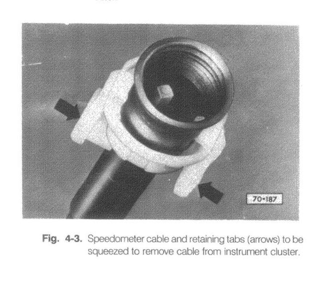

Here's where the speedo cable connects to: -
The speedo cable is a sqaure tube of plastic which rotates in the outer sleeve, and is connected to the gearbox at one end and the clocks at the other.
The rate of rotation is proportional to the speed of the car - you can test this (if you're bored) by getting a screwdriver and sticking it in the hole indicated above - the faster you twiddle the screwdriver, the more speed the dial will indicate.
Reconnecting it should just be a case of screwing the knurled steel nut on the end of the cable onto the back of the clocks - make sure that the square tube slots into the hole nicely before tightening.
However, if this end is broken then you may need a whole new cable - these are really expensive brand new, although Crazyquiff will probably have one lying about…
Any probs post back
Rich

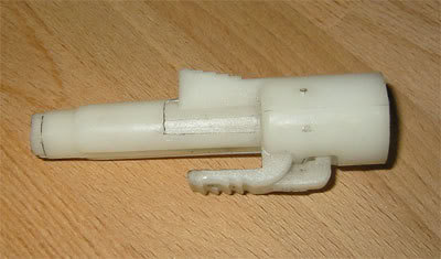

The bit I've broken is the palstic sleeve that clips over the back of the clock. All I'm left with on the cable is a threaded bit about 1/2 an inch or so long with a small nut half way down! It doesn't even look lond enough to reach the back of the clock and screw in, although I take your word for it.
Tian :dontknow:
Do you mean the round bit?  If so then you def need to replace as it will not locate correctly.
This is the bit I busted at the left hand side. Do you think I could clamp it on with tie clips?
Tian

You could try, but in all honesty I dont think it would work.
Do you have rev counter?  You could guage speed until you get a replacement.  ?21.50 from GSF and before everyone slates it for being another rubbish gsf part, i've had one of their speedo cables in one of my golf for over 7 years
I've wraped it with electrical tape and used three tie clips! trouble is I can't see the end reaching the back of the clock. Now that's something I haven't busted! Strange but I don't see how it will get there. Is it the nut shaped bit that goes in and turns the needle?

If you look back to the picture I posted earlier of the cable end, the sqaure shaped cable end is the part that goes into the speedo to make the needle register your speed.
