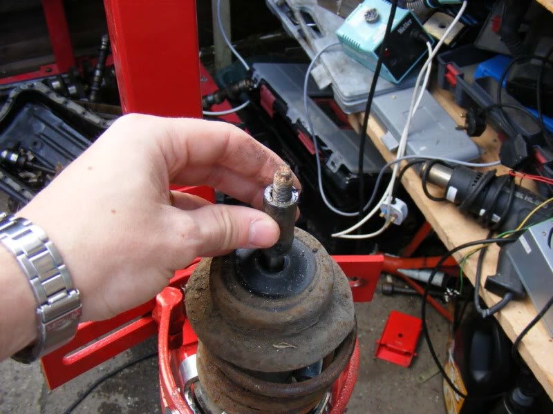

Step 71 - Time to rebuild the shocks and springs now, use a spring compressor (shown is a hydraulic one which will cost you about £70 and is WELL worth it, even if you only do one spring job a year it'll pay for itself quickly - failing that use TWO sets of ordinary clamps). Relieve the tension in the spring
Step 72 - You will be able to pull (and twist) the top mount off
Step 73 - Now use a 17mm spanner to remove the top nut, note you will need to use mole grips or similar to hold the spindle (which has flats on it)
Step 74 - If you find the nut gets stuck at the top where the flats are, hold the spacer directly with mole grips as shown. Be absolutely certain that there is no tension on the spring when you remove the top nut!
Step 75 - Remove the top nut and spacer
