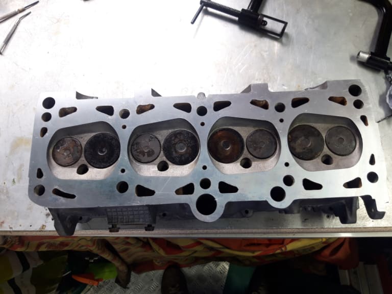

Please see the cyl head after i took it off,it was all ky jelly like in there.

If picture is of the second cylinder head you purchased, it looks pretty horrendous, no surprise it was leaking, its always good to get em skimmed as they go porous. I would say block failure is very unlikely and its almost imposible to get an oil cooler installed incorrectly, unless you have the wrong gasket or something.
I'm willing to bet now you have a freshgly skimmed head and a new gasket that you be all ok, definately worth a coolant system pressure test after assembly, just use plain old water until you know its ok and chuck in a flush and drain to get rid of the crud in there.

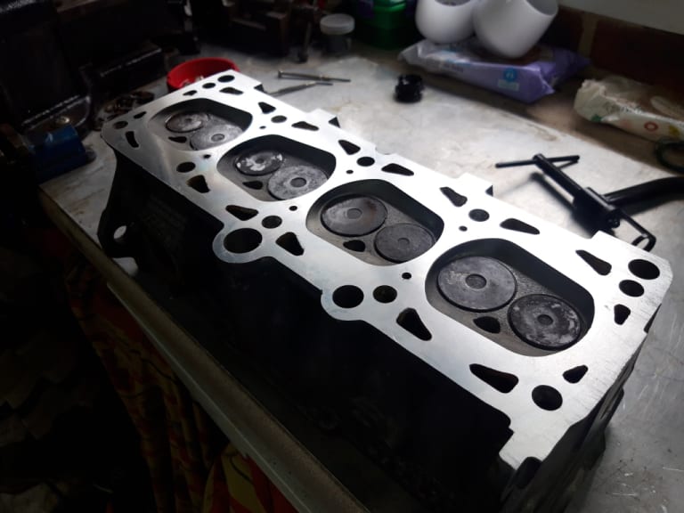

Anyway, the skimmed Cyl head is back and only negative thing I can see is a corner of a hole where the aluminium has gone flaky ..should i be concerned? There still looks to be plenty of meat there (Attached picture)
I've also attached pics of the top of the bottom which we are going to clean up once we mount it in an engine stand.

20201009_131217.jpg 20201009_131254.jpg 20201009_131324.jpg 20201009_174105.jpg

I'd suggest that the leaky core plug and hot running warped the head, and that is the cause of your problems. I wouldn't worry about the bit of corrosion on that water way in the head - the gasket will deal with that.

As Paceman said dont worry about the flaky bits, from the pics that head looks a thousand times better than before. Get yourself some wet/dry medium grit sandpaper and a sanding block and go over to block face, doesn't have to look perfect just smooth and free from old gasket and surface corrosion.
