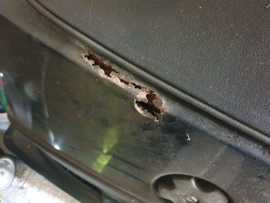

Back in 2005 i bought a K reg Mk1 cabiolet clipper, I think for about £1600. It was the first car I'd ever bought and i loved it dearly, but i never had any money to improve, and barely maintained it. I used it daily until 2010 when i stopped using it. In 2011 I bought a  house with my girlfriend and i reversed it into my garage and I hasn't come out since.
By that time,it wasn't in great condition. The roof has many many holes in, which meant that in boot and part of the interior were damp. There has been a few rust patches develop, particularly on the back panel and the tailgate.
We've just bought a new house, and it's time i decide what to do with my old golf. Should i try and sell it for spares/repairs, and hope to buy a different one in the future? Should i take it with us and try and get it repaired/repair it myself?
My father and brother are both mechanics but I don't have any experience with car repair myself (I'm a cheesemaker by trade).
What do you guys think? Am i living in a dream world when i say that it'll get it done up one day or should i just give up and move on?
I've attached some pics

As you've got somewhere dry to to store it, I'd stick it in there and leave it for a bit if you don't know what you want to do with it. You've got a new house so that'll take most of your time / money anyway and it can wait for another couple of months - you can always sell it next year if you don't want to fix it but you won't be able to sort it if you have already sold it.
The rust doesn't look bad (have you seen my Caddy??) and if you only drive it on sunny days, keep the roof down! Service parts for Mk1s are still relatively cheap, belts are simple to change so it shouldn't take much to get it in a state where you could chuck it in for an MoT.
