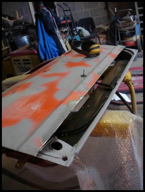

The one door so far is running at 11 hours work to fabricate the bottom inner and then make the outer panel and i still havnt finished it by a long shot. These things take time i guess !
So with the bottom removed, i left the small bit in the centre and put the bar in for a temporary reference.bit of a mess
the other end - nice!
the early start on sat, i have not shaped the end properly or put the drain recess in till later
Many many hours later, the centre section (bottom of pic above) i kept for reference has now been replaced and the raised step in the centre that hold the outer panel away fabricated.. not totally finished but getting there.
the outer panel is made and i have started to fit it, so a few pics to follow later on…

So one door is finally finished, i just cant believe how long it took to fabricate the bottoms but i think its worth the effort to save the original doors.
no filler - hope it fits :mrgreen:
