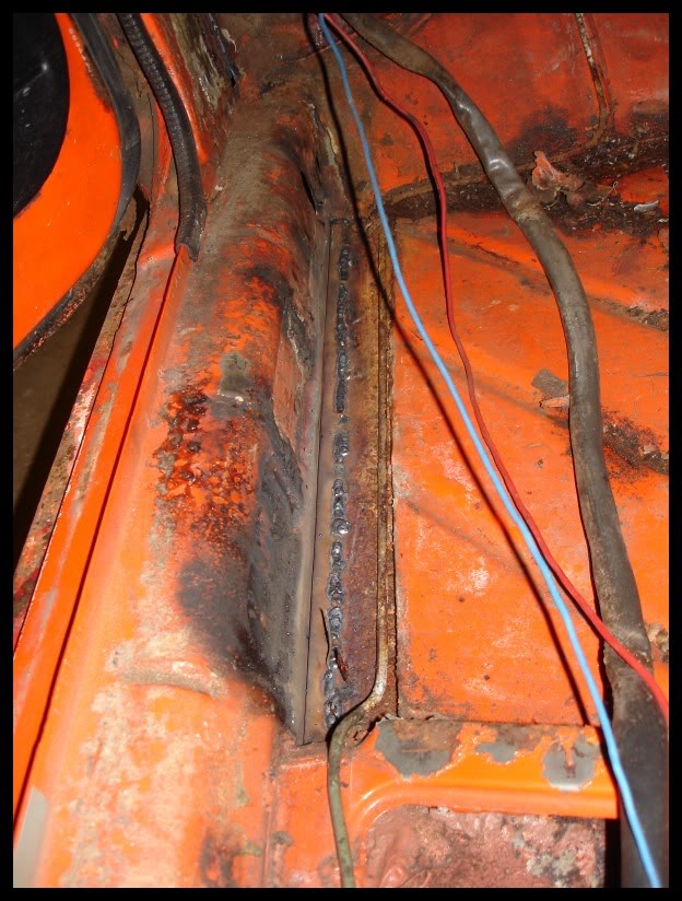

cut the sill back a bit more and straight ready to accept the sill lower. im only using the very bottom as the top section is solid and to keep the early pressings
After alot of work i finally got the sill in, i butt welded it so that its seamless and will need no filler
As new :)
