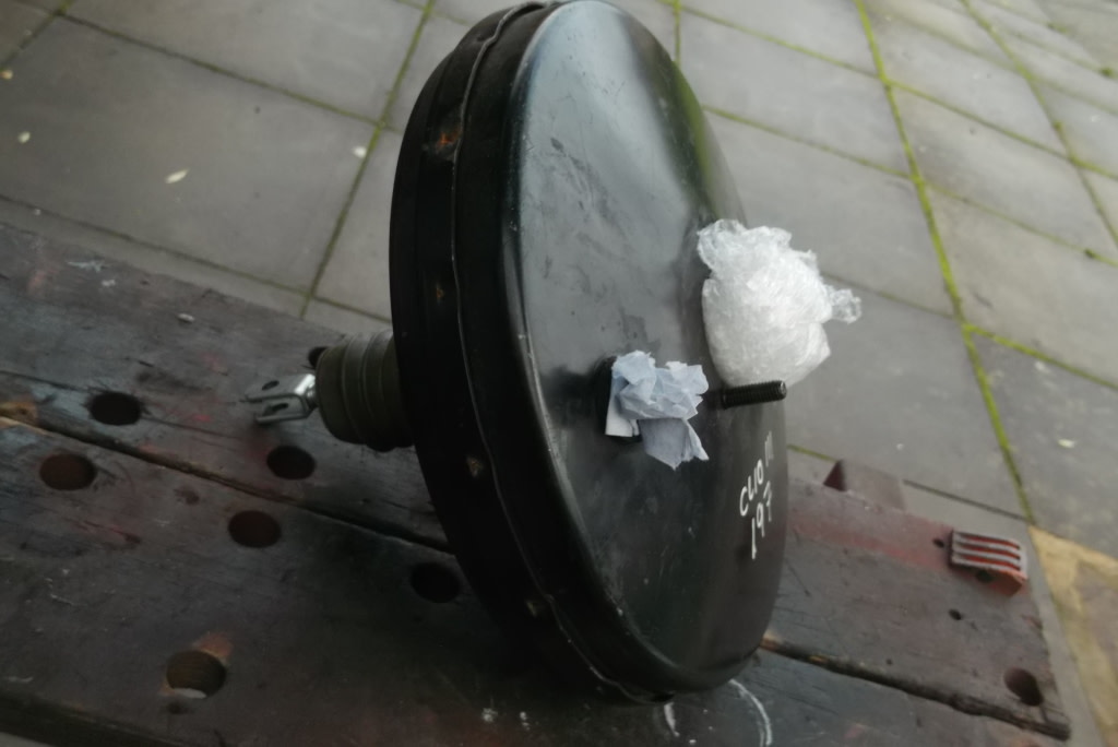

Modified brake cross over linkage to allow fitting of clutch master cylinder..
