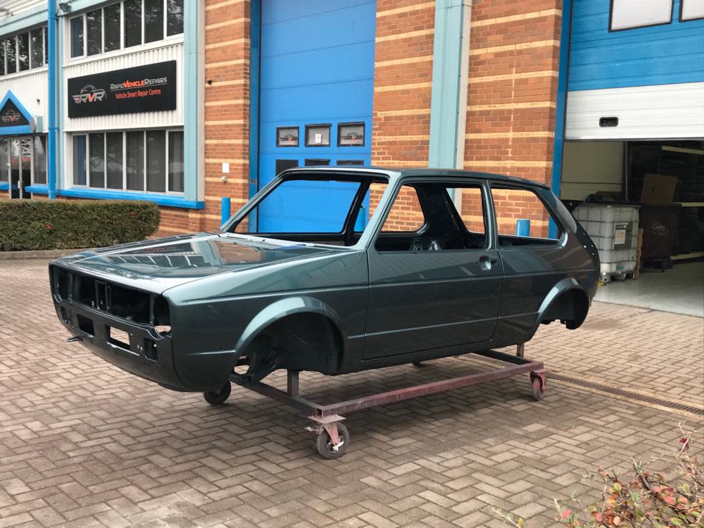

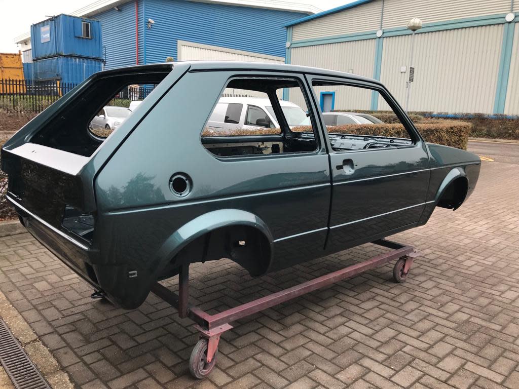

So after my last post over 2 years ago. I realised I just wasn't happy with the quality of work that was done to the body and it was a bit of a bodge up which is my own fault as I was trying to get it done on the cheap, having a young family I thought this was the right thing to do but it has bitten me on the bum. Anyway fast forward to 2018 I decided to have the body done correctly and even bought panels that I had already bought new once as I wasn't happy with them. I was so ready to give up on it and throw in the towel but I'm so glad I didn't. I picked it up just before Xmas and I'm so happy. I can finally start building it after 6 years of ownership. I will keep adding photos of my progress. IMG-20181123-WA0021.jpg IMG-20181123-WA0020.jpg IMG-20181116-WA0010.jpg IMG-20181116-WA0006.jpg
Lovely!
Looking forward to the rebuild… exciting times ahead.
Its going to be a Very Happy New Year this year!!
Absolutely Gorgeous!  You will end up with a stunning car! Such a cool colour!
