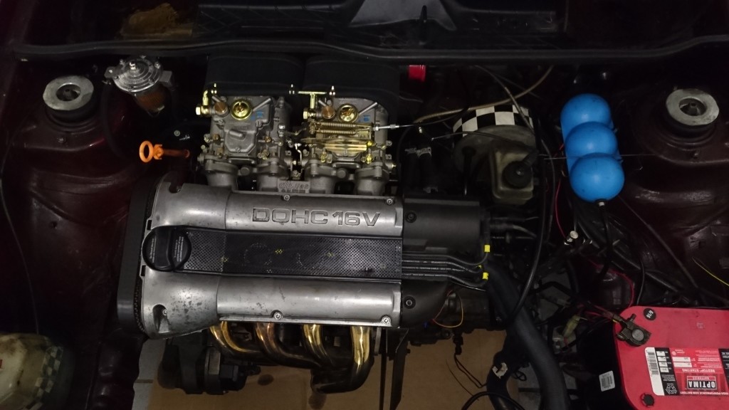

Initially I was going to put a 9a 2 liter in it before I know what a small block was. Small blocks don't exist in the US so it was all new to me. So the 9A won't go without moving a motor mount so off to the web. I stumbled across the AFH, shortly after I found one on ebay and it began. Now  on may second AFH after leaning out and popping the first one. First some pics
Early on
More current, CWV trans (have an 8P and 8N lying around)Running Weber 40 DCOE 151s now (27s in pic, dbilias manifold, MSD 6AL-2 Programmable ignition with the factory AFH distributor, Vacuum pump of a new Polo for the brake booster, Huco self regulating pump, 4-2-1 header and 60mm group A resonated exhaust. KW coilovers BBS RA with 185/45R15s and a bunch of extra wiring a fuse block relays and such to power this extra mess

Depends on your budget really. I'm running an MSD 6AL-2 programmable (part number 6530). They're a bit pricey but it was the easiest way to get what I wanted. It can be wired directly to the factory AFH distributor, that was a bit plus to me.

Friendly bit of advice… If your running dual Weber 40s like I am, they need a lot of timing advance at idle to run right. About 10-12 degrees. That combined with a lightened flywheel doesn't work well. It creates a high cylinder pressure situation at start up. The lack of inertia from the like flywheel causes it to slow down when a cylinder starts it's compression stroke and the ignition fires early. Then as the starter wants to turn faster, the flywheel slows down… I've broke a starter and ate the flywheel twice to learn this.

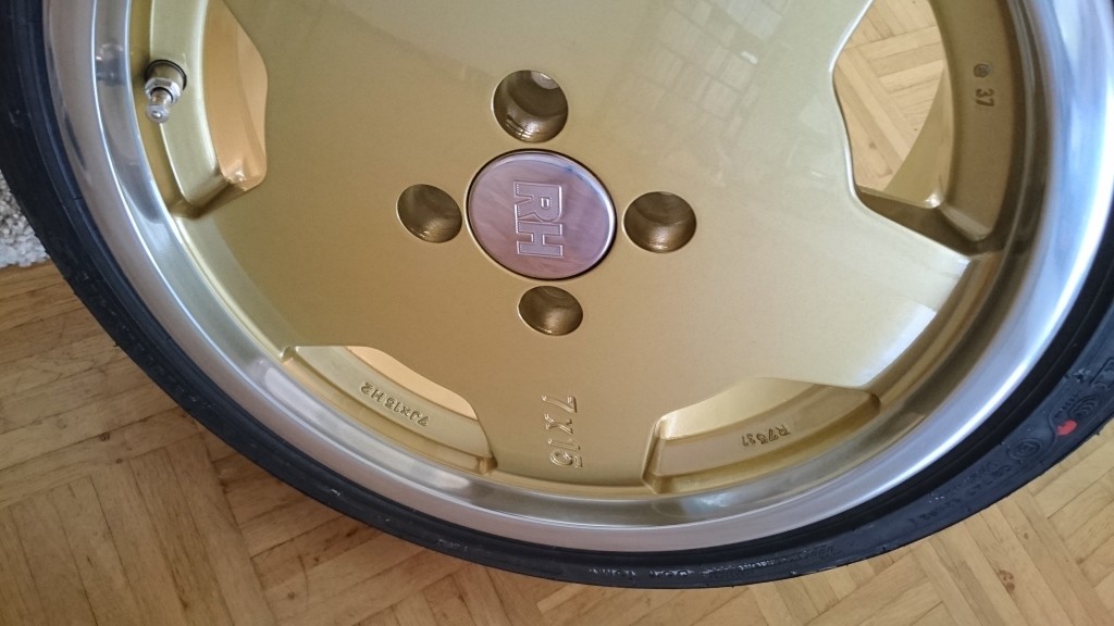

See my videos, Tom W T F on YouTube
Yup they are different!

Motor is back in and running. I reset the carb float levels and went up a venturi size while I had the carbs off. Installed a new gearbox mount, of course it was rubbing on the lower radiator hose. No problem right? The radiator can be moved over one position. Now my cooling fan shroud touches the exhaust. No problem…  Removed it entirely and ordered a universal fan that I can install on the other side of the radiator as a pusher.
A quick test drive showed the float level adjustment made a huge difference, it's on the lean side of power but otherwise I have some minor jetting changes to iron out a flat spot… I'll try to get my YouTube account in order and post some links. More to follow… DSC_0631.JPG
