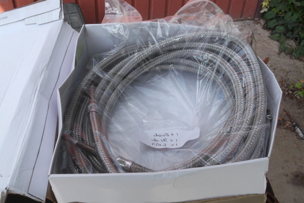

Can't go wrong with stainless CQ's fuel parts  :thumbs:
