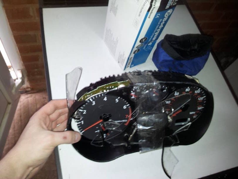

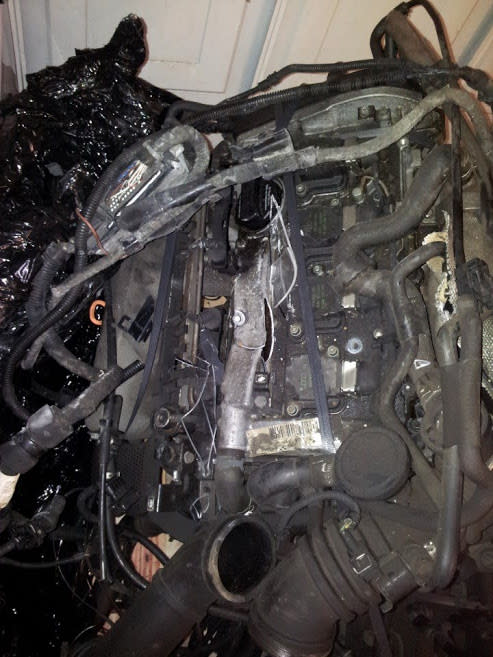

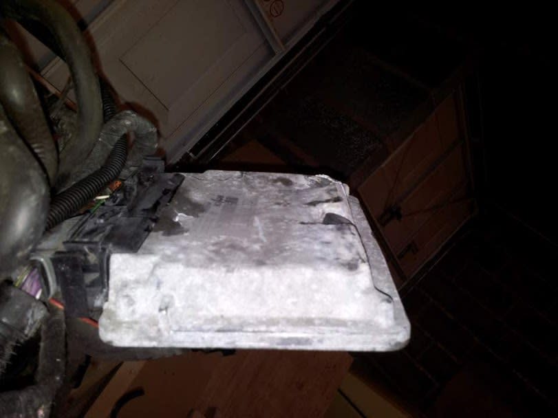

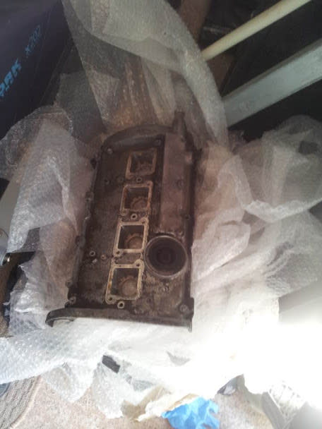

First bit of bad news though. The engine arrived damaged :(I don't know how the couriers could have done this but the rocker cover is squashed at the front, ecu was on the engine in the same place and was squashed, instrument panel was on top and shattered and finally the loom was damaged.
The seller is apparently going to send me replacement parts next week.
gallery_23668_406_63593.jpg gallery_23668_406_69433.jpg gallery_23668_406_104108.jpg gallery_23668_406_112576.jpg gallery_23668_406_167440.jpg

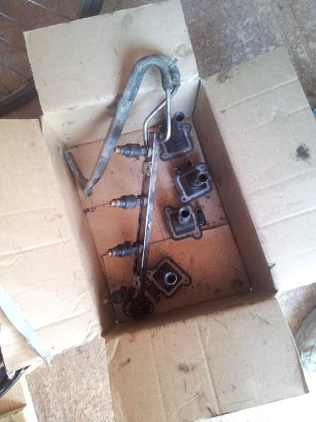

Ok some good news, back on track. Replacement parts arrived today :) gallery_23668_406_16382.jpg gallery_23668_406_22589.jpg gallery_23668_406_85374.jpg gallery_23668_406_150755.jpg

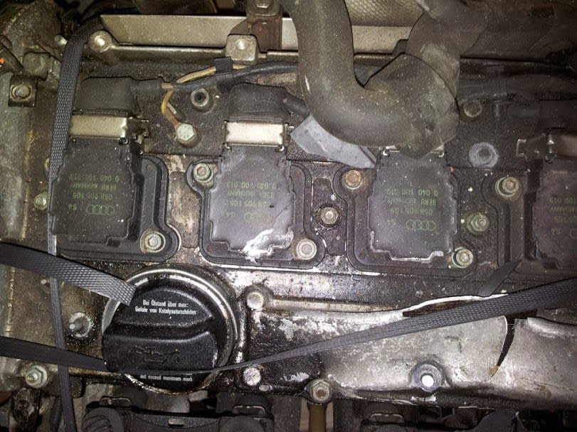

Started to strip the engine down today. Removed the wiring loom and gearbox. Was about to mount it to my Clarke engine stand but don't have any M12 bolts, will pick some up tomorrow.
Does anybody have any tips for removing the flywheel without the special 3067 that locks it in place?
gallery_23668_406_145850.jpg gallery_23668_406_153319.jpg gallery_23668_406_167655.jpg
