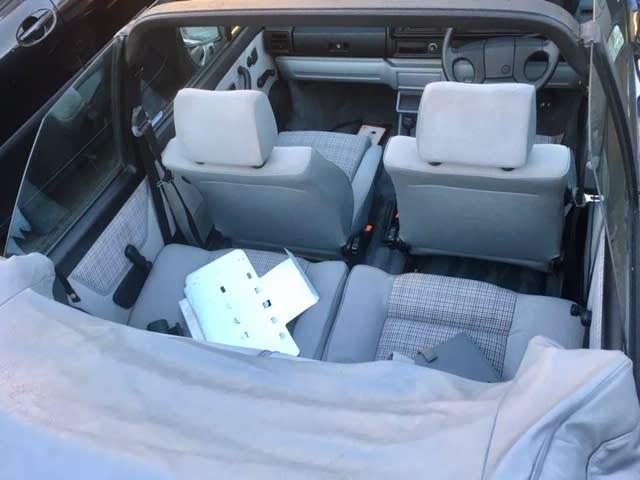

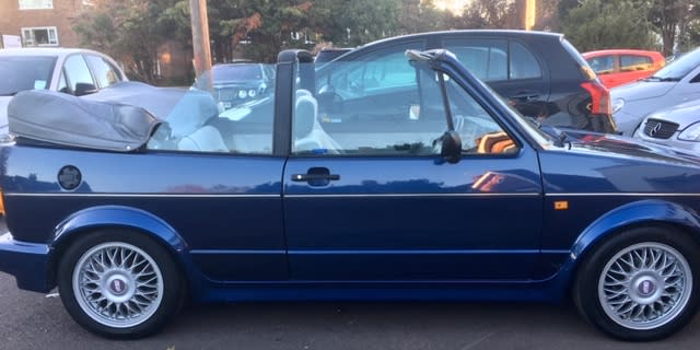

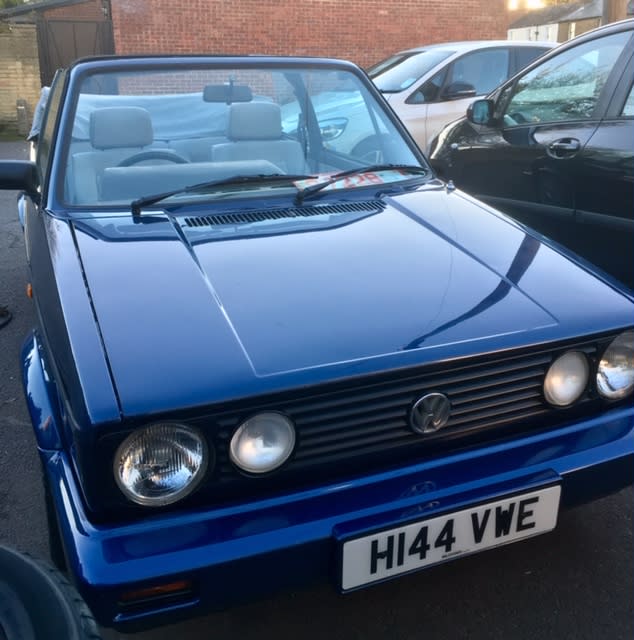

Well - been to take a look at my first Cabby.
Used VOLKSWAGEN GOLF CLIPPER, BLUE, 1.8, Convertible, Hampton Court, Surrey | London & Surrey Cars
I must say a fine example, but at 8k - I have high expectations.
the guide on this site was SUPER helpful and even a total novice like me, is now able to hopefully, dodge a bullet now and keep sellers honest.
Here are my observations:
1. New roof needed. Electices were good but saggy inside, torn outside. Guy knocked 800 off or offered to have done
2. Rusty petrol pipe - now this was a bad issue on my orginal back in the day - and made me nervous
Seller seemed shocked and immediatly ordered a new pipe there and then - seemed genuine but i wonder if there is damage to the engine?
3. a few cracks and new seals needed here and there but overall, it was a real beauty and VERY orginal
4. the drive was great. engine sounded sweet, not tapity', no smoke, picked up lovley and ran cool.
5. steering pulled left a litte - again seller immediatly agreed to fix
6. brakes - oh my, they are poor - BUT its the first car like this ive driven for YEARS and im used to my new BMW 2 series and wife's brand new Sportage - this car had brand new brakes and hadnt been driven
7. gears, crunched twice getting into 2nd - warning lights in my head - but with a new clutch, i ensured I floored it and the crunch dissapeared. Seemed ok

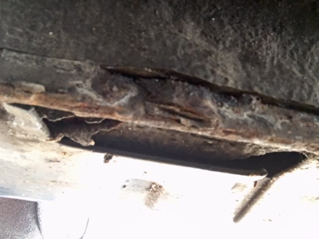

8. bodyword - the paint job was Excellent, minor marks but for age, excellent. the rust in the pic was from under the door sills. not too bad to be fair. IMG_2323.jpg IMG_2324.jpg IMG_2325.jpg IMG_2327.jpg IMG_2331.jpg IMG_2332.jpg IMG_2333.jpg IMG_2334.jpg IMG_2335.jpg
Take a look at the pics - i'd love to hear your thoughts and thanks for showing such interest.
NB: the following taken from the seller's website: 'With updated CD player and electric roof. In what I would say is an above average condition compared to some of the Clippers still out there. Our workshop has completed a full service, timing belt change, gearbox oil change, clutch replacement, four brand new tyres and MOT safety prep to leave no advisories and keep you as safe as can be. A great overall example, a true classic'
As nice as it is, its isnt an 8k car.
Lets be honest if it was a private sale it would be 6.5k tops to start with.
Its not a bad one by any means, in fact its quite a nice one but its the time of year when cabs can be had for not much money and I think you can find better for less, particularly if you stick to private ads

100% new roof needed
Seller agreed to sell for 7200 with rxksiting roof or for 8k with new roof
I'd not give anywhere near that kind of money for it.
4K maybe.
You could get a lovely tin top for 8k.
Keep shopping.
I doubt it's going to be snapped up at that price. Most people wouldn't even consider it tbh as, in my opinion, it is massively overpriced.
I'd be a little concerned with the crunch into 2nd as this is usually a sign of the gear bix being a bit fragile and probably on it's way out. The top selector dohickey spring thingy gets worn and then the gearbox ends up jammed in one gear.
At least you have a good starting point to compare others to  :thumbs:
