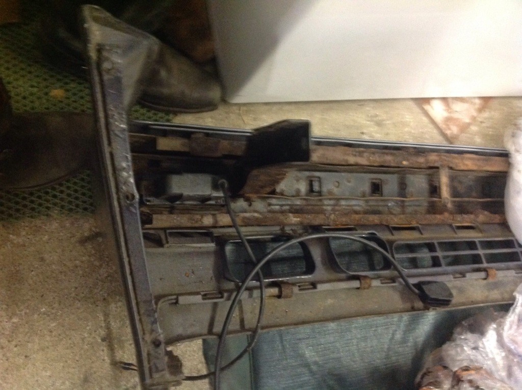

currently replacing my front wing on my 1983 golf which is actually a hard top but has clipper bumpers skirts and arches on, when taking the wing off I had to obviously take the front bumper off to avoid scratching new wing, when the bumper was off I had to take the cover off the actual metal bumper to fix one of the bolts that had broken off and now I can't get the cover back on the actual metal bumper :(( I took it off by removing the numerous black clips but due to my shocking memory I can't figure out what way they went in and how I could put them back in. Does anyone know how to reattach the cover properly or another easier way of doing it as a couple of the clips snapped anyways :(Got a picture to show what I mean, excuse the horrible rusty metal bumper  image.jpg image.jpg
They are a wedge, and go in to spread the fingers tight against the steel.
From the first picture it looks like the Bumper cover isn't fully inserted in to the Bumper support bar.
Oh nice I see what you mean so if I get the metal part into the cover then just hammer the wedges in and they should stay tight?
You don't have to "hammer" them in, they usually will insert and hold with a good push of your hand.
I suppose a couple of taps on a it with a Pliers would suffice.
I'll try again tomorrow morning but it wasn't holding when I tried that before
Should I put the clips in before I put the metal bar in or put it in and then the clips?
When I replaced the clips I had the car Jacked on the front and on stands.  I could then push on the bumper cover, and insert the clips. and see what I was doing.
