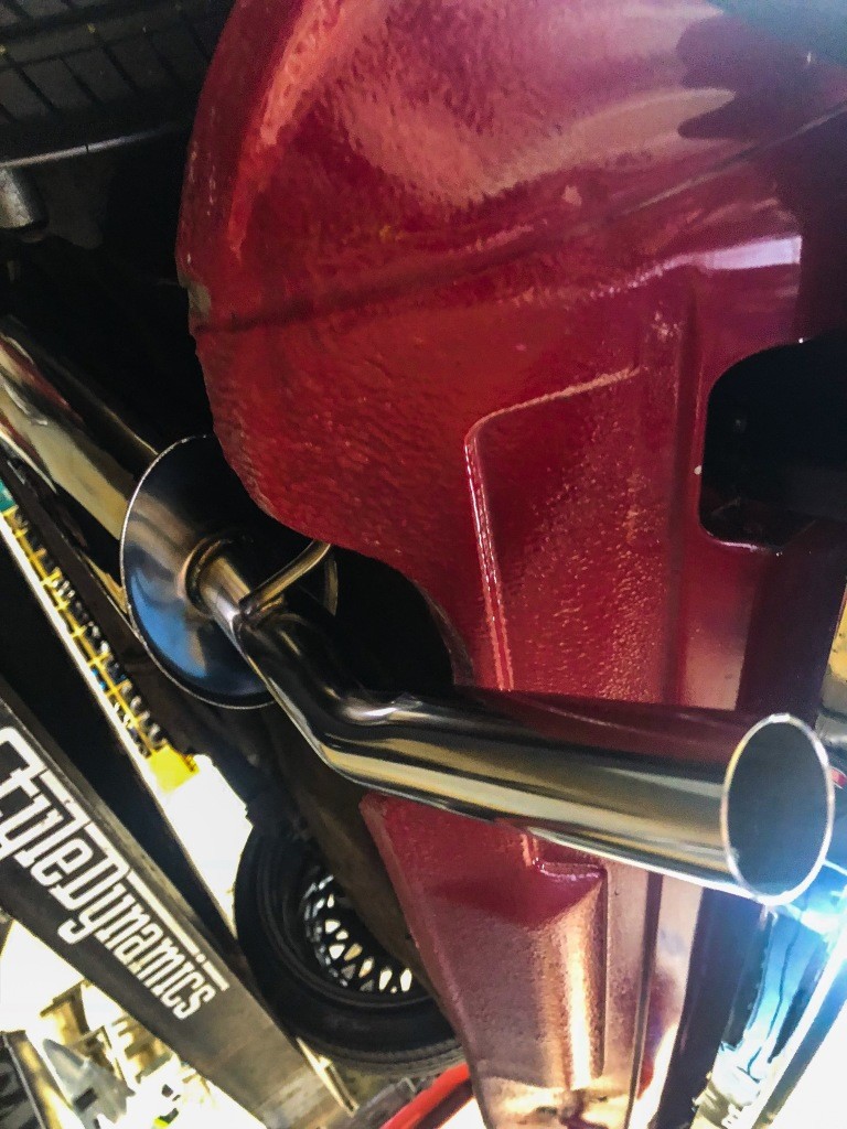

I just had a manifold back exhaust custom made with 2 silencers and upsweeping tail pipe. I have the 1.8 auto and it sounds amazing its not too loud but loud enough to know its there and when it gets hot if I let off the throttle I get a nice burble  :)
Please can you share how much you paid for this and where you got it done? I think we may be local to each other so if it's in our area even better.
I paid £550 all in from the guys at style dynamics in Hayes. They are so professional and very friendly
