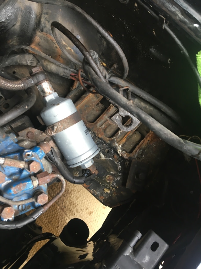

Well went out for an hour to attack the other side and found a rusty but not rotten battery tray. Kept the fuel lines attached as I don’t have spare copper washers may need to move the car hence will fight the metering head for a couple of hours each night.
Now in the process of rubbing back the tray ready for some phosphoric acid then some paint. Rusty bits on the inner are are nothing has wiped away and can be easily treated and painted over.
Only wanted to clean it now doing bodywork. I hate body work it is so boring doing the prep but will be worth it. Wish I owned a dremel right now.

Now about those top mounts. Funnily enough I had the same comments on Instagram from a friend also.
The reason I started doing this is that I am waiting for a nut splitter to attack the bottom bolts on the front struts they are totally gone. Corroded, rounded and seized. I get all the luck.
But as I do when I have to abandon one task I take a look at the next. This was the rocker cover gasket. While off I decided to send it for powder coating. 2 weeks that will be. So now I have a stuck car in need of bottom bolts on the shocks, a rocker cover and I’m stuck.
So decided to test how hard the wax oil will be to remove and here I am. Getting dirty and high on fumes.
However as I come full circle and paint the battery tray and protect it from more corrosion.  Clean up the easy to reach waxoil parts. Replace the rocker cover and cam cover back on. Clean all the pipes and bits I have taken off along the way and eventually remove the front struts to get rid of the corroded and stuck coil overs for the original set up I will in the end replace the top strut mounts.
Still awake and with me. Because next will be the rear suspension. I hope to Christ is comes of easy or with this run of luck I will be removing the fuel tank and fitting a new rear beam.

Should be safe with the struts when jacked up the springs are loose as the platforms have been wound so low.
Will fit spring compressors anyhow just to be on the safe side.
To be honest the awkward sanding of the battery tray is most likely to kill me off first. Did I say I hate body work already. I hate it. I would rather be shot with a top mount any day.
