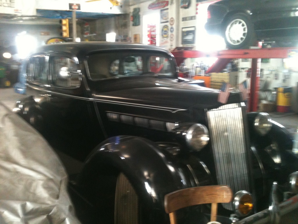

But my Brother who has a 36 foot tall garage, has a 4 poster lift that he bartered for, I think he said it cost him about 500 USD.
37 Packard in the front 89 mecedes on the lift.
He has more cars, and he can get a full sized Yukon up 8 foot and still have about 8-12 feet above it.
