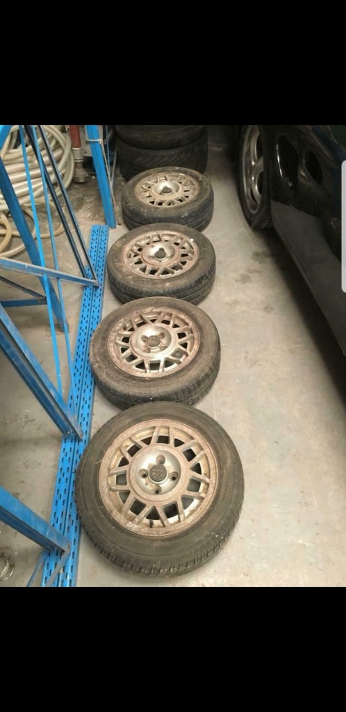

Hi guys, bought these wheels tonight extremely cheap I know they need a refurb but what's the best way to have them done? Any pictures of your Scala wheels? What should I be roughly looking at for a tidy refurb ? Screenshot_20190822-175750_Gumtree.jpg

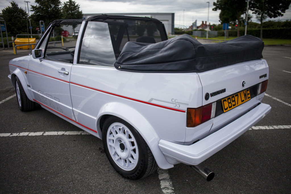

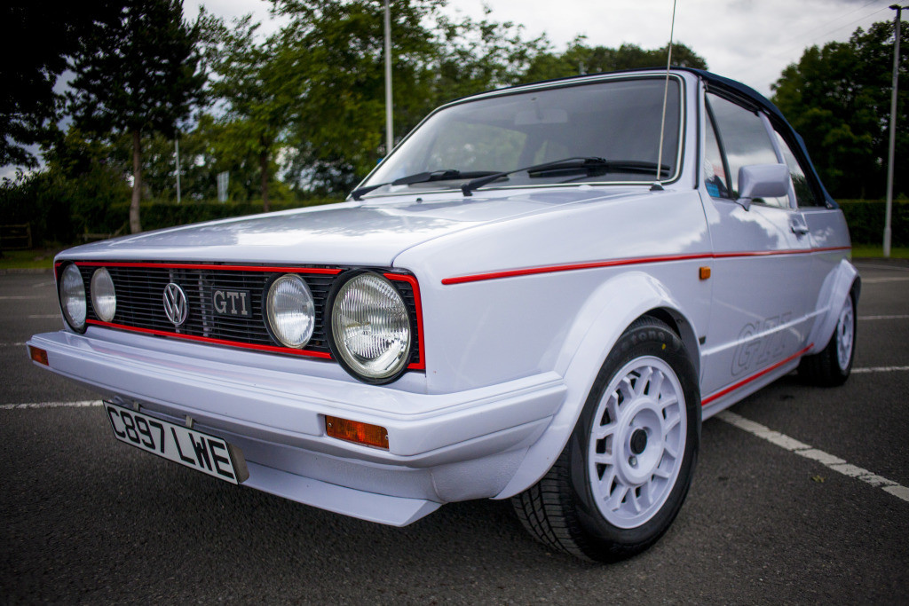

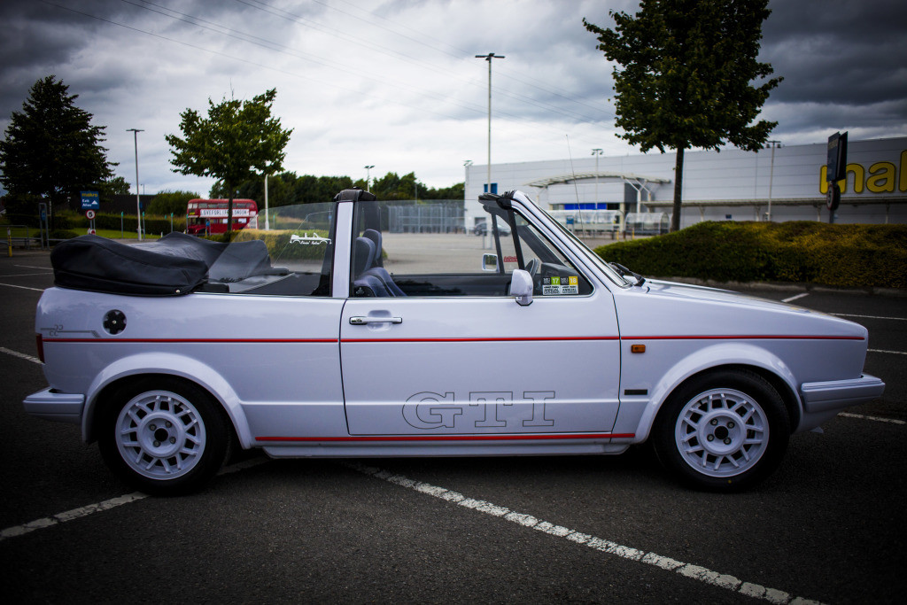

here are some photos of my snowflakes! - finished in a alpine white with gold fleck.

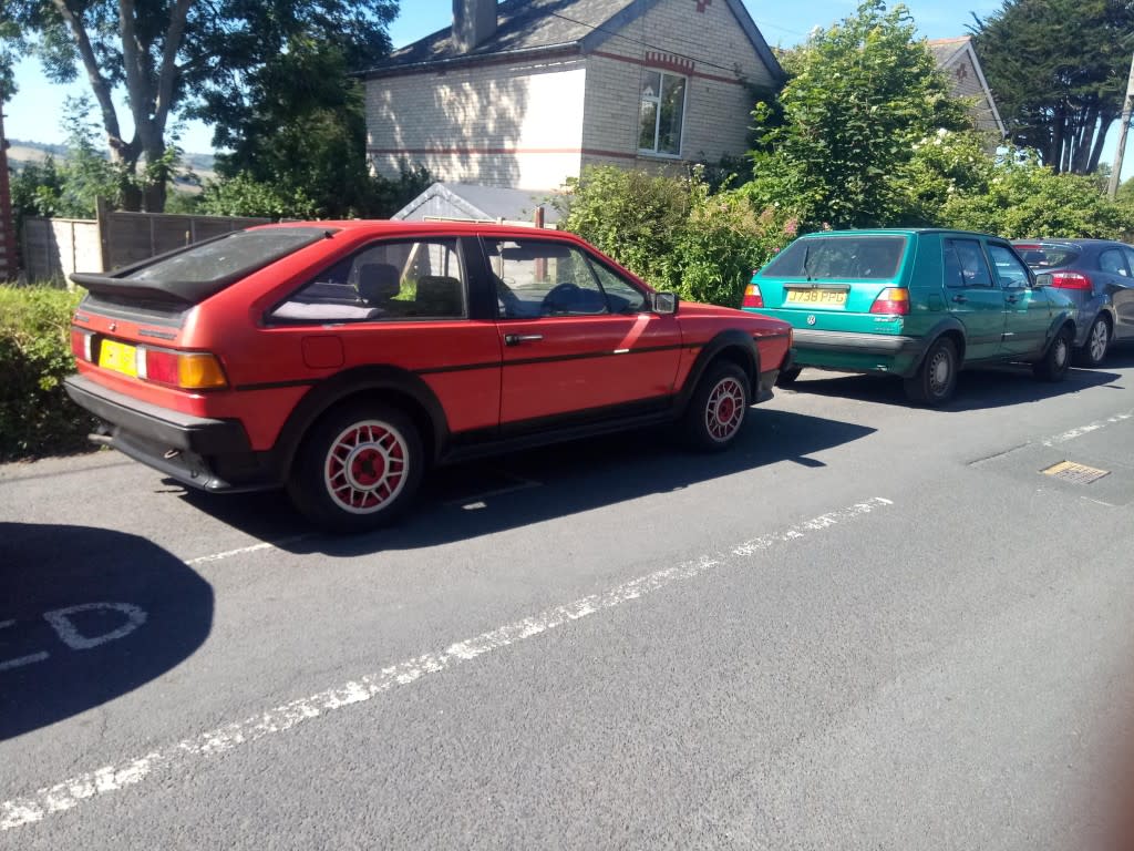

Most snowflakes were painted then diamond cut.
A lot of wheel companies don’t diamond cut them as the face is intricate.
You can of course bead blast, dip strip then powder coat on one solid all over colour.

I had a set blasted and powder coated silver, then I added the black with fine line tape for masking, and a can of gloss black aerosol- came out a treat

Look nice mate
Yes I know its a Scirocco. The cabby hasn't got new, wheels yet.
