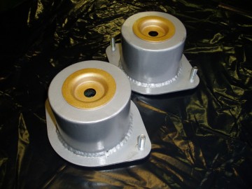

might want to look into strut top extensions; moves the top mount of the coilover higher, allows you to raise the coliover higher to get a better ride.

Mk1 Golf / Jetta / Caddy – Raised Strut Tops | coltechclassics.com
theres look better than some as well
in the short, it places the top mount of the strut 1.5 inches higher, means that you can unwind the coilover by this distance, keep your current ride hieght but allow the damper and coil not to work under such large compression giving a better ride; in short.
